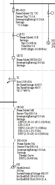

John-Jack wrote:
...... This is particularly a problem when you show fuses, molded case circuit breakers, and relays on your one line. SKM forces you to use the same datablock for each element, but then their library uses the same fields differently in each element. It is a royal PITA to get consistency in one line layouts in SKM due to how protective elements are stored in their standard library. ........
Sorry, but I don't really follow you on this. Can you provide an example of the issue and I'll see if I can help. You sound like you're more experienced with SKM so probably not, but I'll try.
Here are some bogus PD's with the Settings parameter turned on in the datablock.
I know exactly what John-Jack is talking about, E-Rated fuses is a great example. Sometimes "E-rated" it is in Type, sometimes it is in Description. Sometimes the description contains only Amperage.
Or when I had them model the G&W TNI switch with VI Controls, they modeled each fuse curve as a different type. So if you wanted to see how a different curve would look, all the settings would get changed when you changed the type. But the curves for the G&W are like those for the SEL-751, all contained in the same device... It's not a different type. I told SKM that they could use the SEL example to model the G&W, but they still sent the lazy version that they did.
And before Brent says that "there is a workaround for that, so it's not an issue for me" I would say this shouldn't even be an issue in the first place. If there are 40,000 users of this program, that's 40,000 workarounds. Or alternatively, one person at SKM (Sherman) could actually model the equipment correctly in the first place and then 0 workarounds are required.
