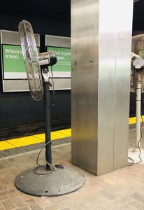

What is wrong with this scene at a subway station?
 Post subject: Re: Quite a fan
PostPosted: Fri Feb 22, 2019 10:01 am
Joined: Fri Feb 22, 2019 9:57 am
Not in keeping with NEC Art 422.33 in that this is not a factory installation

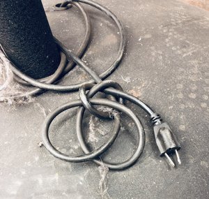

One of many missing grounding pins found in and around train stations using fans. They may have been removed by someone who uses the train to go to work, or it's just a lack of proper maintenance by the staff.
