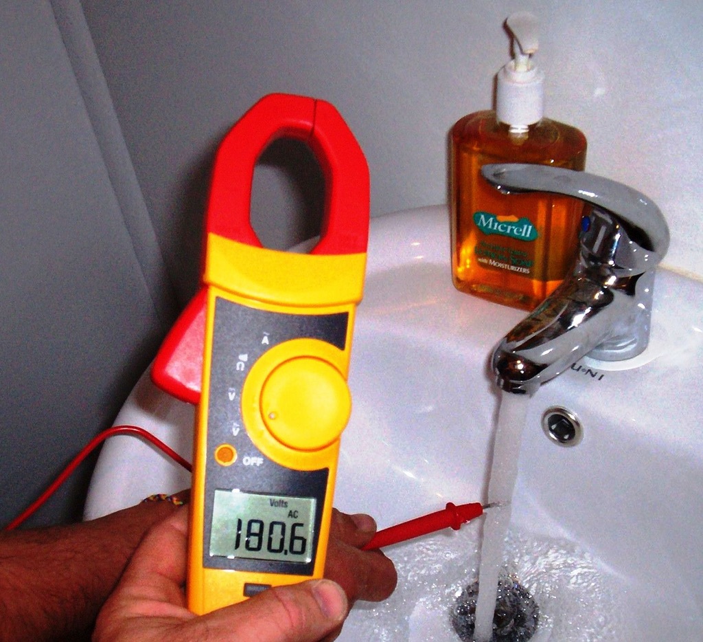

Joe Tedesco wrote:
We found this condition on many inspection tours!
File comment: Voltage present at the sink?
