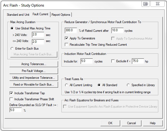

Thank you for the reply. I agree with your points but I don't think it fully answered my question. I attached this diagram to help illustrate what I was refering too.

Let me expand as well: The key question is how much seperation is required between the main and (in this instance) the MCC. Do you feel it makes a difference if larger conduit size and quantity is used (i.e. 1-2"C vs. 3-3" conduits for larger parrallel sets)?
