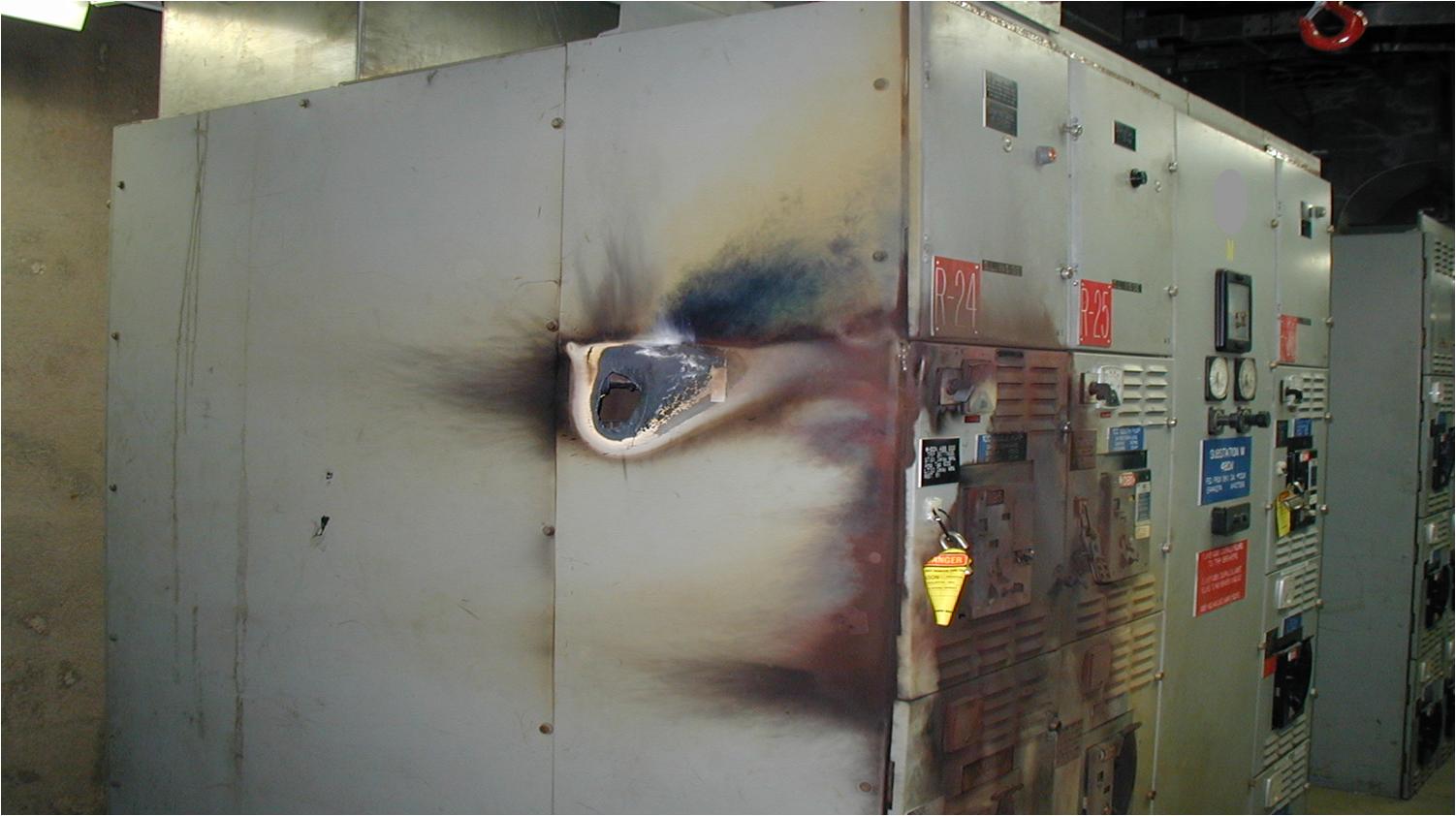

We have created a portable temporary power system - supply is 480V/10A single phase into a toroid transformer, output is 120VAC/40A.
The components are enclosed in a NEMA 1 aluminum enclosure. The interfaces on the front panel are standard 120V electrical outlets. What is the potential for an arc flash with this equipment? I can provide a schematic if necessary. Here is a picture of the system. Each unit has a 480V/120V Xfmr.
Thanks.

The 480V source is one phase (i.e. A-B) of a 3 phase 480V supply. Each phase is fused at 60 Amps at the source. However, in this system each phase is fused again at 15 Amps. The toroid transformer is only capable of drawing 10 Amps max on the 480V side. There are no copper bars in the system. Each connection employs insulated wiring. I have attached a schematic for reference.
