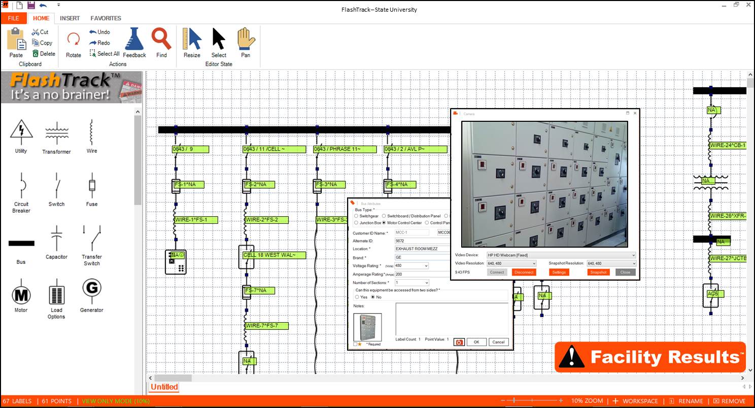

Below is an excerpt from IEEE 1584, it looks like tests have been performed on 50hz and 60hz. I'd be curious as to what would be a conservative approach to a 25Hz system. Is this a portion of a system? or is utility 25Hz?
[ATTACH=full]244[/ATTACH]
