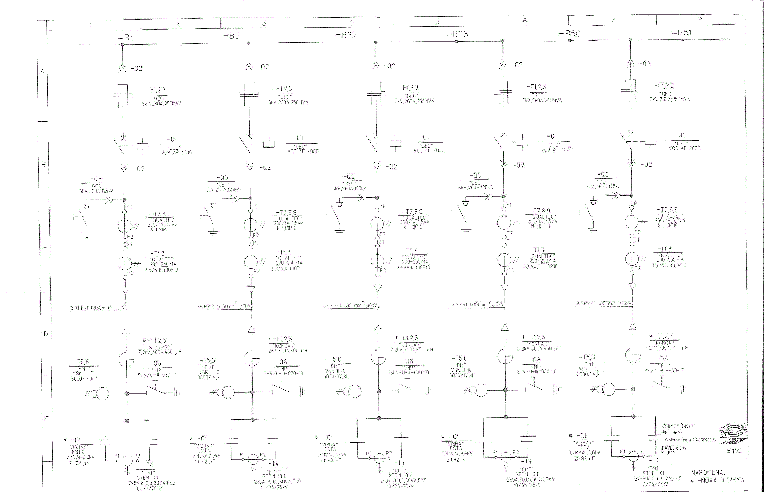

I have a Fire Pump Controller that is directly tapped of the main transformer (1500kVA, 12.47kV-480Y/277V) and as one would expect the arc flash hazard is 63 cal/cm2. This makes is impossible to do any work inside the controller as the circuit breaker is inside the controller. I suspect this may cause some issues in testing and maintaining the fire pump controller and fire suppression system.
I am sure other people have experienced this situation and would appreciate any insight on how you handled it.

You are right. If there is no OCPD ahead of the Fire Pump Controller there is not much you can do.
However, many times, when I consider the utility overcurrent protection at the primary of the utility transformer, the AFIE is reduced to levels below 40 cal/cm^2. Other times it doesn't. The only way to be sure is to perform the calculations.
So call the utility, get that information, run the arc flash study and see if the AFIE has been reduced.

Thank you. The results shown are with the utility fuses taken into account. The system setup is 100K fuse links, 700ft of utility cable, 1500kVA pad (12.47kV - 480Y/277V).
Even though it is not entirely my issue, I am concerned on how fire pump testing is done. From talking with an electrician he said motor currents are verified by clamp on readings taken from the motor leads inside the fire pump controller cabinet. Obviously this can't be continued and will probably have to be done in the motor peckerhead. I do not know what other readings need to be done in the fire pump controller for annual testing and certification.
I was thinking that a fused disconnect could be installed upstream but have not researched the code on that.
