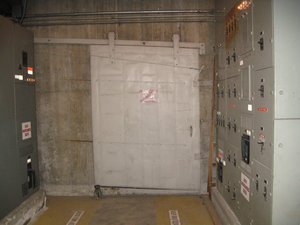

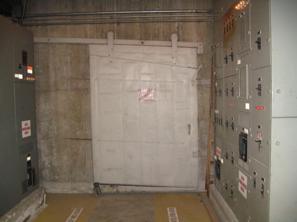

EDIT: Oh, I was able to dig up a pic of a couple of our switchboards that have the fault lights on them. See below.

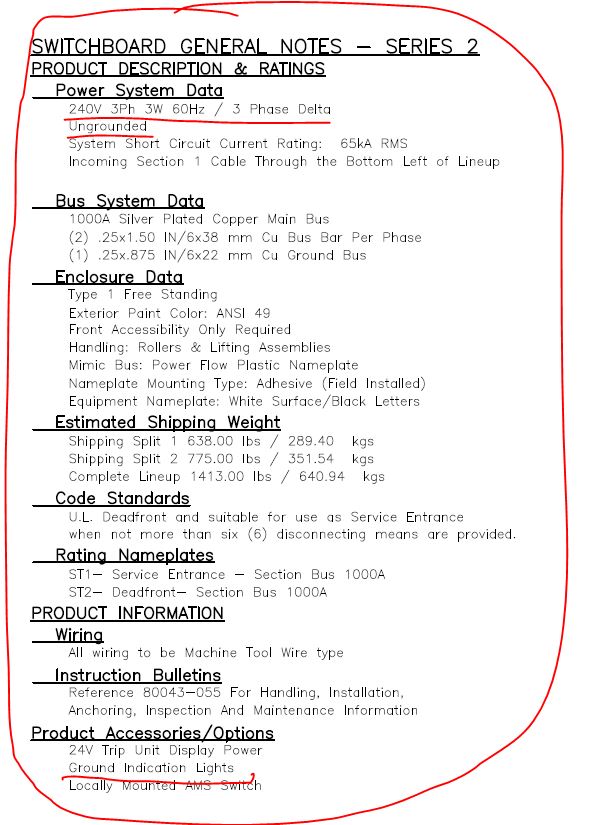

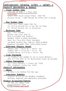

I bought a new switchboard for one of these type services a few years ago. Here were the particulars.
