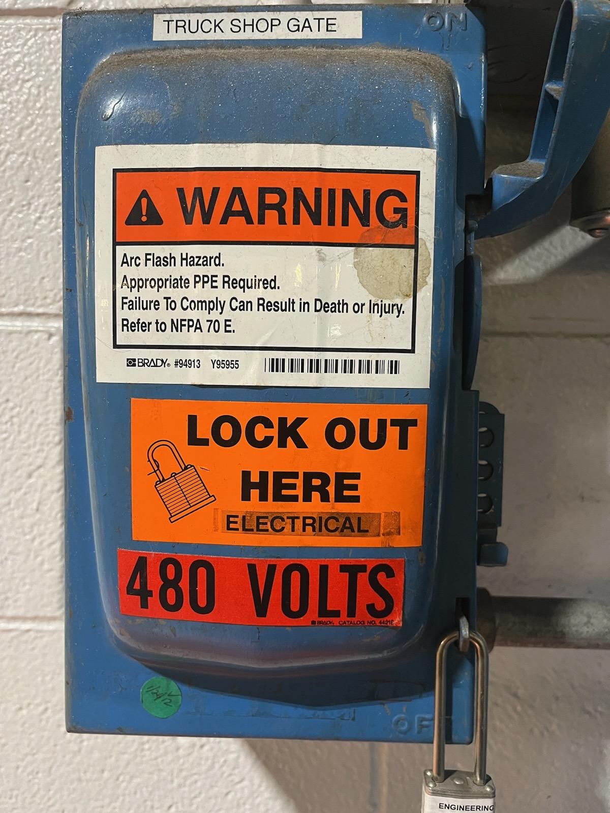

Question:
How would you handle this?
Thanks in advance..
Phil

Sounds like you need an updated study...the calculation methodology has changed since 15 yrs ago. As an interim, you could use the table method in 70E, but you have to be very cognizant of the limitations and footnote boundaries for its use.
Mike

[ Are you referring to the AC voltage 130(C)(15)(a) and the DC voltage 130.(C)(15)(b)?

Pretty much what Mike said.
To use the table method you need to know and understand what fault current and clearing time means.
Where are you located? There are probably some members on here that can give you a proposal on performing a study and labeling.

I'm in Georgia. The tables you are referencing are the ones I cited above?
Those tables are what we call the "table method". To reiterate, there are very specific limitations listed in the footnotes. Also, via this procedure, PPE is selected via table 130.7(C)(15)(c).
