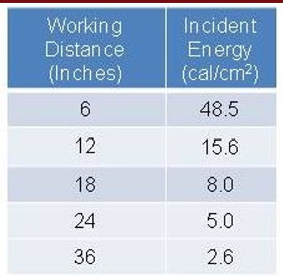

Hello, I am new to arc flash studies and have been assigned to gather some data from a local hospital system. I will be occupied by an electrician to open and remove covers.
My question is: how would this be possible to collect data on live gear with the covers off? There is no existing study or one line to use as reference. I need to model the data from the utility downstream. It seems like an impossible task or maybe beginner initiation? If they remove covers, I will not be able to be in the room. So items I need are CT ratios of MV relays, conductor sizes. From my understanding these can only been seen with covers removed.

The other approach could be that I would proceed with the job and wear daily wear PPE (20+ calorie jeans, leather boots, 8-12 calorie shirt, 12 calorie arc rated gloves, and safety glasses) and stay well away from equipment, never entering the limited approach boundary if at all possible and absolutely do not enter the restricted approach boundary. Incident energy drops quickly with the square of the distance away from the equipment. For example, an IE of 8 calories at 18 inches is only 2.6 calories at 36". I would use that logic for most of the distribution, but not for large, 480V equipment fed from transformers over, say, 500 or 750 kva without some type of protection at the transformer secondary, especially in a smaller room. More on this later.
I wouldn't wear the balaclava and face shield unless I suspected I was entering the arc flash boundary. This would just be based on experience. Under 400A branch 208V volt panels in larger rooms or corridors are probably covered with daily wear and keeping my distance. Put the balaclava and face shield on if I had to be within say, 6 feet or so. Again, this is just my opinion on one way, right or wrong, to handle this.
