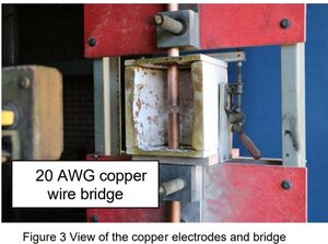

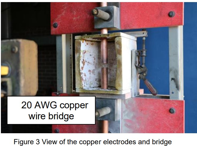

Test setups in a lab were built to test 240V single phase and higher. Test results were basically all just a fraction of a calorie/cm^2 with arcs not being able to self sustain with parallel electrodes like you would have in a typical panelboard. One of the studies the conducted tests with the electrodes in-line, end-to-end as well, as opposed to parallel. ie the worst case scenario for trying to sustain an arc. They were able to get sustained arcs and measurable incident energies in the end-to-end, "in-line" configuration. I can't really envision what a "real world" in-line condition in a panelboard or load center would be.
Any thoughts on this? How do you label single phase panels? Today, if I have the occasional 120/240V single phase panel as part of a larger 3 phase distribution system, I just model those one or two or three panels as 3 phase since that is supposed yield a conservative result. Many others probably do the same.
