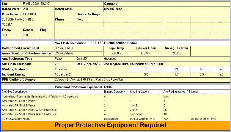

PostPosted: Thu Sep 03, 2009 2:08 pm
geh7752 wrote:
Specify that the electrical contractor has documented proof of arc flash training and is equipt with the proper ppe as part of the contract.
Yep, use this

PostPosted: Thu Sep 03, 2009 5:24 pm
Capt Jim wrote:
Hi Zog
I think we are all connfused about qualification and approved training . Besides this signed statement what proof could you ask to see :confused:
Well that form covers the facility for liability, I suppose you could ask for proof and documentation of the required training.
As far as qualification and "approved" training it is up tp the employer to determine what training (Classroom and hands on) is necessary to meet the 70E requirements to deem thier employees as "qualified" persons.
