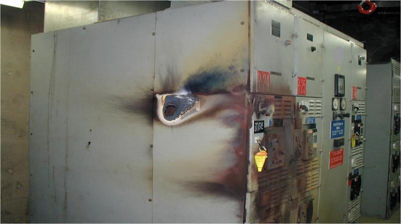

Recently a Arc Flash Study was completed at my facility-several of the labels list the protective device as being a feeder,i.e. a conductor-Iam not an engineer but something tells me this is wrong.What do you think? :confused:
