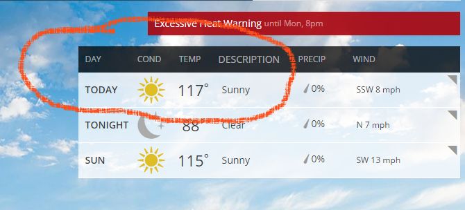

At home (Arizona) it hit 117 degrees yesterday, the forecast was only 113. Today's forecast is 117 so who knows what it will really hit.
Here is the question/scenario: Let's say there is some major electrical emergency in the middle of the day that requires energized work. It is located outside. The arc flash label states Category 4 PPE (40 cal/cm2) protection is required.
What would you do?
