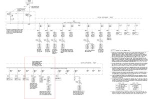

I think it depends. It looks like you have motor loads hanging off your main switchboard, so those could feed into faults at your new panels. If they are on VFDs, then maybe you don't have to model them as added short circuit contribution (unless they have a bypass, then maybe you do).
