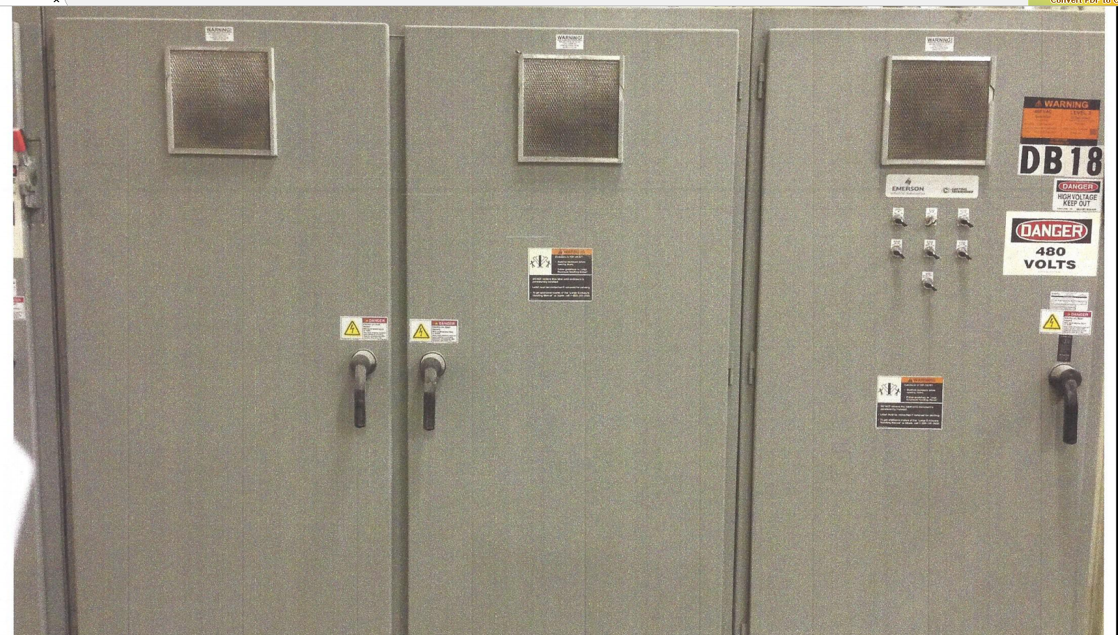

What does the actual energy profile vs. time look like if you diagrammed it out?
PostPosted: Wed May 22, 2013 7:13 pm
Not sure if this is a question or a statement with the diagrams to show it???

The diagrams show a couple of my perceived possibilities.
In a short-duration event, I think they would look like the time-constant profile curves. I am not really sure in a longer tA whether the energy has an initial peak then a lower level while it is arcing or whether it is just a stretched out time-constant profile.
I realize "short" is relative. In this context, I mean perhaps less than 1/2 second or so. If an incident stretches out longer than a second, it would seem there would have to be a high amplitude initial blast with a lower level of energy as the arc is sustained.
I was really just considerring if we should be protecting ourselves against the peak energy or the total incident energy - which is likely dependendant on tA.
Not to say that the danger of a longer-duration event should be dismissed, more that the danger of a short-duration event is greater. All the incident energy released in a short tA equates to a higher blast pressure in comparison to a drawn-out incident.
