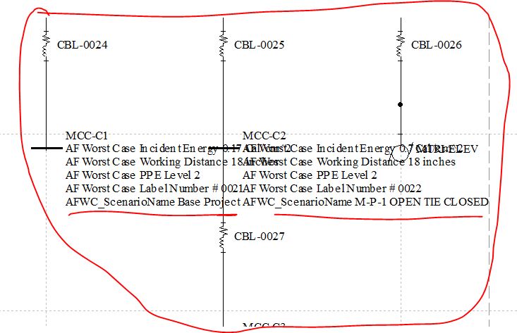

that works perfect, the only issue i am finding is that the SLD only pulls the information from that scenario in.
i.e. bus 1 is worse case in scenario 1, bus 2 is worse case in scenario 2, but i cannot get the datablock to show the worse case from both scenarios, instead it only shows that scenario result.
therefore the SLDs and the Results Table do not match (unless i print 2off x SLDs, one for each scenario - however, that would result in 24 SLDs which i dont really want to do).
any ideas.
 Post subject: Re: utility fault contributions
PostPosted: Mon Jun 17, 2019 3:18 am
Joined: Fri Jun 14, 2019 5:51 am
Posts: 13
sorted, found another datablock that is arc flash worse case.
much appreciated for your help

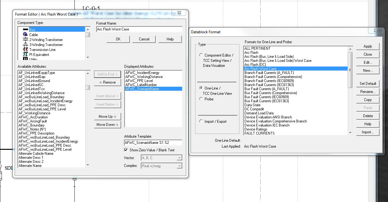

Did you find a Datablock Format Attribute that has the worst case? I'd be interested to see how it reports it, and does it state which scenario. This would be good to find for example when the scenario is emergency system transfer switch position E versus N.
PostPosted: Tue Jun 18, 2019 4:23 am

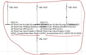

You can edit the arc flash worst case datablock and add the scenario name in the editor.
