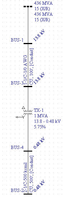

Generator Time Current Curve
Hi Everyone,
This is a great discussion - lots of good comments and thoughts. I attached a time current curve that hopefully helps the cause. It looks like the generator MCCB with a high setting would probably not trip according to the generator decrement curve. If the fault current is arcing, the liklihood of the breaker tripping goes down although at lower fault currents, the difference between bolted and estimated arcing currents shrinks. So now the question is:
1) Could the arcing current sustain itself?
2) If it does sustain itself, would it last as long as it takes for the breaker to trip according to its curve (I doubt it)
3) Do you cut the time off at 2 seconds (makes more sense but could give high HR category using 120 cycles)
4) Do you use the 70E Tables which have limits on the arc duration in the footnotes that would be exceeded
I'm not sure there is a right answer yet (I'm not sure if that means there aren't any wrong answers :cool: ) This seems to be another one of those cases where we are trying to get precise with a piece of the puzzle while the main IEEE 1584 equations aren't that precise (yet)
And..... to make this more exciting (??) the NEC requires that the emergency and legally required systems must coordinate with the supply overcurrent devices i.e. generator breaker would ususally be set high for coordination - :eek: Augh!
I am interested in anyone's comments and thoughts - this is a good one!
