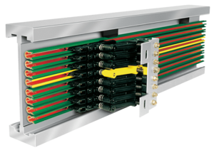

Any suggestions or experience modeling conductor bus bar / rail system used for mobile equipment - e.g. a hoist or crane - see photo above.
Thank you for your thoughts!

In what scenario is someone exposed to a possible arc flash event on these conductor rails? These are elevated and in my experience personnel are unable to get near them while performing any standard work task. A risk assessment would then identify the chance of exposure as none and therefore no arc flash hazard needs to be identified.
With that said, I have modeled crane rails many times to determine the arc flash hazard at the control panels located on the crane deck. One customer had several 100T cranes with rails spanning hundreds of feet and with multiple points at which the rails could be energized. I modeled each accurately and identified the point at which the crane could be positioned and the worst case arc flash hazard associated with it.
That is what I want to do - to know the hazard at different points since even for LOTO and deenergized work proper PPE must be known/prescribed. Which electrode configuration did you use? Thank you for replying.
