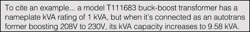

I'm asking because Buck-Boost Transformers operate as an autotransformer, and can supply a load much larger than its nameplate suggests. See example from ACME (Hubbell) website http://www.delzer.com/hubbell/acme_cat/#122/z on page 122. Buck-Boosts can be up to 10KVA+ in size, and could potentially supply a load of 200KVA, depending on voltage.
Buck-Boost Transformers ARE THE SAME as an isolation transformer, just with terminal connected in a different order. So if you observe a 10KVA transformer on a branch circuit, you might ignore it. But if that is supplying a 100KVA load at 240V, it would be a mistake to overlook that since you would have 240A of load.
My inclination is to ignore the transformer, and treat the circuit as continuous from OCPD to load. But I know in the event of a fault, the primary windings can saturate which limits the amount of current that can get through to the secondary. I'm interested to hear everyone's thoughts!

100KVA three phase 240V load. 100KVA / 240V / 1.732 *1000 = 240.56A, single phase would be even higher, 417A.
VA is conserved so VA in is equal to VA out plus loss.
True, VA is conserved, but it will not match the VA listed on the nameplate. See the attached picture in first comment or follow the link. It is not unusual for a BB Xfmr to supply a load 10x the nameplate rating, depending on the turns ratio.

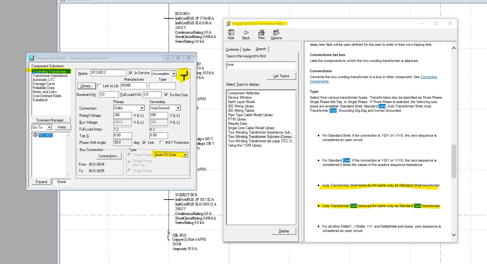

Agreed. But the fault at the secondary is not completely limited by xfmr impedance like it is in an iso-xfmr, because the secondary is wired directly to the primary. So modeling with an iso-xfmr would be incorrect.
SKM Power Tools has a TYPE option in the Component Editor where you can select "Auto-TX Shell" or "Auto-TX Core" but it doesn't seem to do anything. I don't see another way of adding an Auto-Xfmr. Can ETAP or Easy Power do this?

I think you're right that changing the connection type in SKM to Auto-TX Core doesn't do anything. Here's what SKM Help says on it:

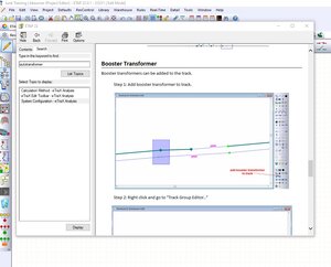

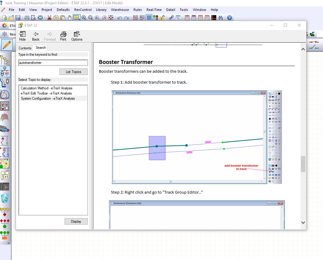

I don't know about EasyPower but I did a Help search in ETAP after I could not find that option to add an autotransformer or buck-boost in ETAP and it came back with this, among other things:
That said, my experience level with ETAP isn't nearly what it is with SKM and I have not used whatever modeling method or operation ETAP is referring t there. If you have ETAP maybe you can do a similar search and get your answers.

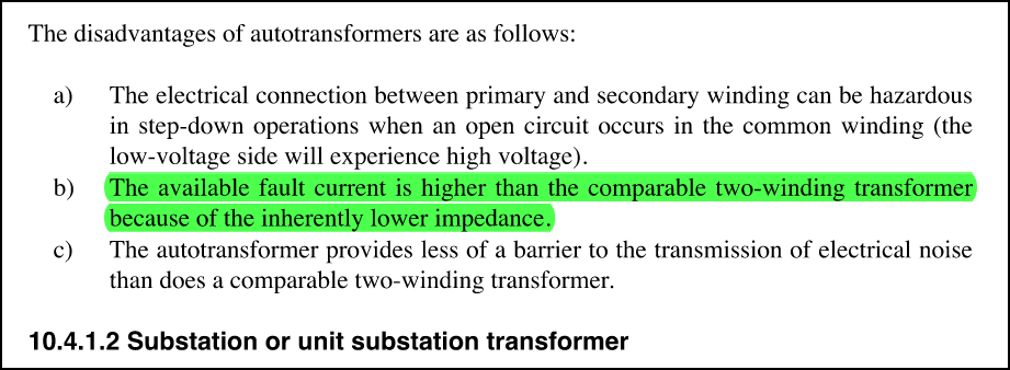

Thanks for looking into it and the info. I happened to stumble across this in the IEEE Std-141 Red Book, Chapter 10 section 10.4 for completely different reasons.

With auto transformers only the secondary winding is in series with the line. The nameplate impedance is for both windings. I've never been able to find out how to determine the impedance of just the secondary in series. After much investigation, including contacting manufacturers, no one has been able to provide an accurate answer. Would love to find a white paper on the subject.
 Post subject: Re: Modeling Buck-Boost Transformers?
PostPosted: Mon Jul 24, 2023 2:07 pm
I'm not sure why you would want the secondary alone, since it is magnetically linked to the primary.
If the buck boost transformer nameplate kVA is based on the bucked or boosted capacity, the nameplate impedance % should follow. Suggest: Convert impedance % to ohms secondary, then convert to impedance % based on the through capacity. Now you have an equivalent 2 winding transformer you can model.
Per my understanding of IEEE standards, impedance of autotransformers is based on output volts and amps.
