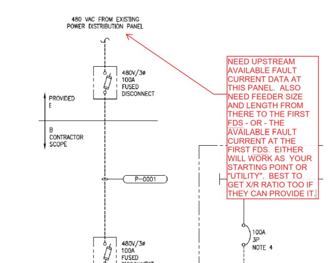

I'm attaching a drawing to better explain myself:
1)Do I ONLY need the short circuit from the 480VAC EXISTING POWER DISTRIBUTION PANEL? or do I need the info from where that POWER DISTRIBUTION panel is connected to?
2) The question asked was: since we are connecting the panel to a delta delta transformer and that to a 100A fused disconnect at that to another fused disconnect, he is asking if our point of connection is the first fused disconnect instead of the 480V EXISTING POWER DISTRIBUTION PANEL and thus we only need the info of that first fused disconnect instead of the 480V EXISTING POWER DISTRIBUTION PANEL

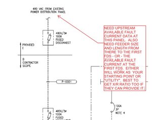

1. If you can get the available fault current at that distribution panel that will be fine an you can model that as the utility, you still need the feeder size and length from that distribution panel to the first disconnect though.
2. Not sure I understand question 2 but if so, you need the fault current at the upstream distribution panel and feeder data as described in 1. above OR if they can tell you the available fault current at the first fused disconnect switch instead that would work too as your "UTILITY".
