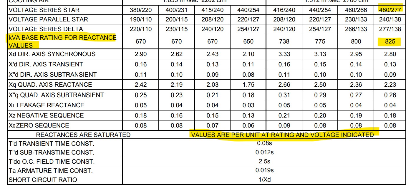

After thinking about this and looking at the data sheet for one of the generators, I think I may have answered my own question. I think you have to use the alternator rating, not the entire generator set rating. My reasoning for this is, the alternator will have a "base" KVA and the decrement curve data is often given in per unit.
The alternator manufacturer doesn't necessarily know what engine the alternator will be paired with and what the final genset output rating will be. They only know what their KVA rating is at a particular voltage. Data sheets are published for the alternator. I think therefore, you must use the alternator kva rating in the SKM model for the per unit decrement curve information to be accurate.
At least for fault current modeling, not for load flow.
Make sense anyone? Agree / disagree?
Here is the nameplate and the data sheet for a 480V, 500 kw genset. As you can see, the alternator is 660kw rated at 480V. The engine-alternator combo is only 500 kw.
