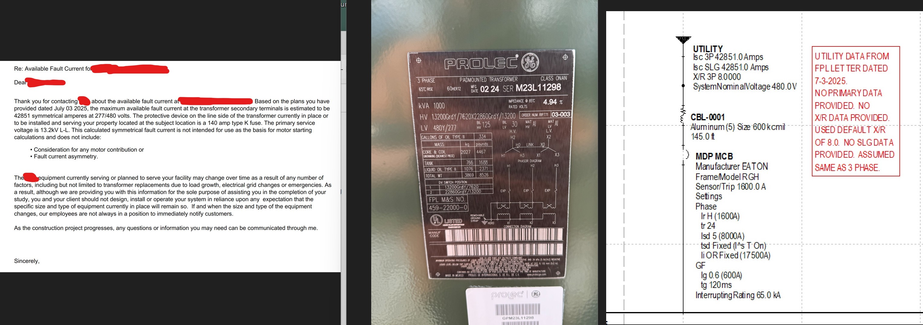

Yes. I have almost this exact situation on a current project, except the POCO gave me even less information so I have to run with what they are willing to provide. I know the primary voltage and the pad mount nameplate but they won't provide the primary fault current data. Only secondary 3 phase data. No SLG or X/R data. See below.
NOTE: THIS IS NOT ADVICE OR A GUARANTEED TO BE ACCURATE OR APPROPRIATE WAY OF HANDLING A SITUATION LIKE THIS. IT IS ONLY ONE EXAMPLE OF HOW I AM CHOOSING TO HANDLE IT IN ONE PARTICULAR INSTANCE.

If I am reading this correctly, the utility company provided 3 phase fault current almost double the secondary infinite bus calculation for the transformer installed. I know utilities can be difficult to get information from, but this looks to be inaccurate data. I had a project last year and the site had 11 service entrances. We struggled getting data that matched what we field verified and ended up the utility maps were not accurate, so I know from experience the engineers in the office don't always know what is in the field. I would question that data for sure because that secondary fault current would be more like a 2000 KVA than a 1000!

Excellent observation. I didn't think to check. I'll look into it as it is important to have accurate utility information and it will make a difference in many ways. (1000)(1000)/(480)(1.732) = 1,202 amps. 1203/0.0494 = 24,352 amps.
