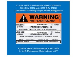

Color?
Symbol?
Wording on the label?
Any opinions welcome.
