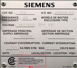

Is this a switchgear or switchboard? You say SWG, which I assume means switchgear, but you also mention 30 amps fuses and a panelboard.
It would be useful for you to post pictures. Specifically a picture of the nameplate on the gear as well as pictures of the gear itself and the room it's in. Seeing those could help members to get a better idea of the context.

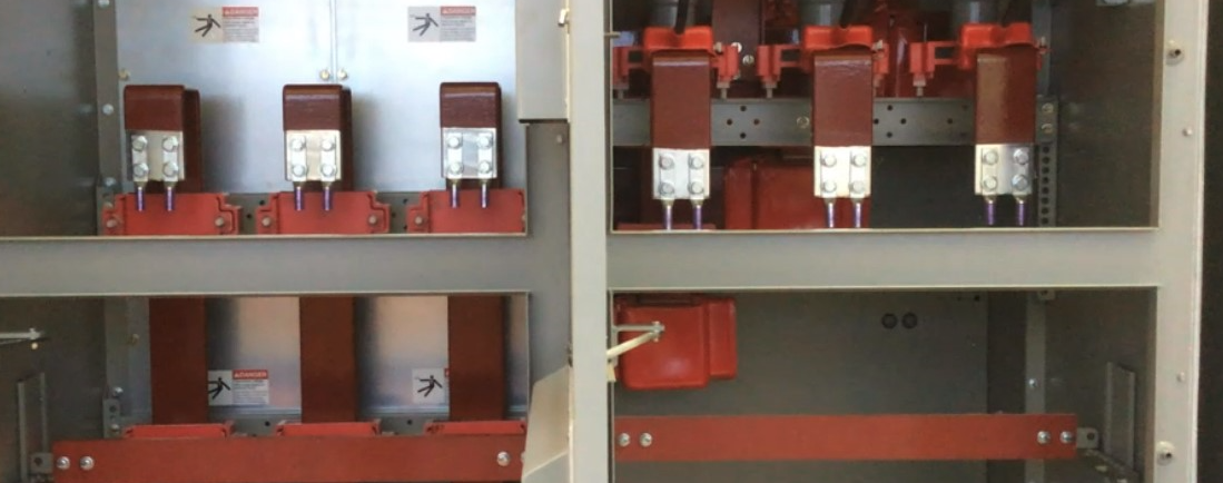

I uploaded the SWG nameplate
File comment: swg nameplate

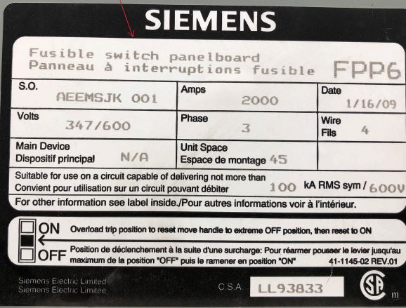

 Post subject: Re: LV SWG Arc Flash calculation (with panelboards)
PostPosted: Tue May 21, 2019 11:08 am
Joined: Thu May 16, 2019 4:10 am
and the panelboad nameplate, SWG front compartment starting cubicle 3

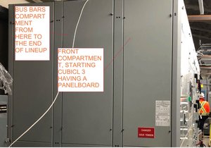

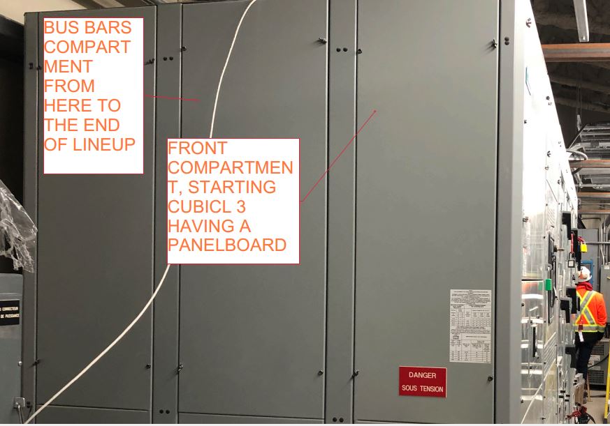

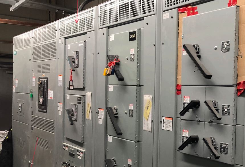

PostPosted: Tue May 21, 2019 11:13 am
SWG front and side view

I treat that type of construction as having (1) Arc Flash value, based on the incoming lugs, for the entire switchboard line up. I don't believe there is an internal compartmentalization at all. An Arc Flash in one of the fusible switches could easily propagate to the horizontal cross bus and then across the main protective device.

Now I have the Siemens confirmation, the equipment is a Switchboard.
I found in ETAP a tool, is a manual setting calculator for arc flash energy, really nice tool.
It confirms, the 18in working distance is outside the restricted boundary area and the energy at this distance, as expected, is about 24cal/cm2.

So, according to the nameplate data the restricted approach boundary would be 12" but that has zero relevance on the arc flash incident energy. Two separate hazards. Just my opinion...but we teach they are separate.

Looking at the ID tags and photos, This gear does not look like it is a switchgear. Based on the photos, I'd urge you to treat the entire gear as a switchboard and label the entire swtichboard with the highest arc flash calculation, that is UNLESS you can insure the main breaker is properly isolated from the rest of the switchboard.
My concern is propagation of an arc that starts inside the main disconnect cubical. If the main breaker is properly isolated by a barrier from the rest of the board, then you could consider labeling with two arc flash values. One at the main and one for the rest of the board. The arc flash at the main breaker is probably very high. But I'd imagine the arc flash values fall sharply after the main breaker.
There are some options to consider. First, I'd contact the manufacturer (have the ID tag available) and ask if the main breaker in this gear is isolated to prevent an arc from spreading to the rest of the gear. Second, you might consider the fusing on the primary of the transformer feeding the board. If this is a utility provided and owned transformer, you should be able to get information on the fuses. It's possible the fuse may help limit the arc flash, however, I don't think considering the fuse is necessarily a wise idea and I don't think relying on a primary fuse is always wise. Finally, if the manufacturer states that main breaker is isolated to prevent an arc from spreading to the rest of the board, does the main breaker have an "instantaneous" trip option? If it does, it's likely the instantaneous trip could be set to reduce the arc flash hazard downstream in the switchboard portion. It is also possible there's a maintenance setting or switch on the main breaker. If there is, I'd recommend using the maintenance switch or setting when working on the switchboard.
