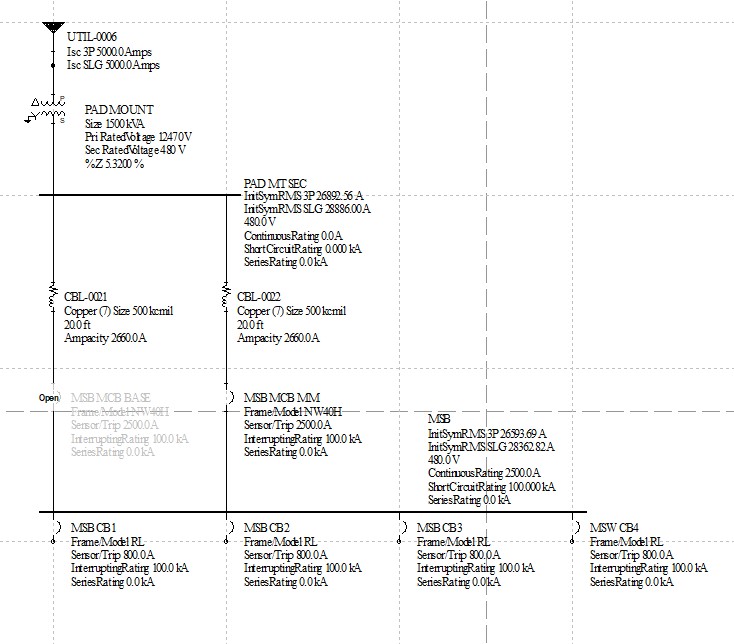

Unless I'm misunderstanding I don't know why you couldn't model two main breakers in parallel, one with the normal settings and one with the maintenance mode settings and put the MM breaker out of service in the base scenario and the normal settings out of service in the MM scenario. No scenario would have both main breakers in service at the same time.
 Post subject: Re: Arc energy reduction mode labeling
PostPosted: Thu Jun 22, 2023 12:54 pm
Example. Base MCB is normal operating condition. MM MCB is maintenance mode operating condition.

One other thing, on new designs, I've often found that maintenance mode doesn't help much or any at all. Especially if the construction of the switchboard or panel is such you have to use the line side of main for the IE calc.
Even if the main section is barriered or you are using ArcBlok technology or other technology maintenance mode often won't help much unless you have built-in delays in your instantaneous setting on your main in normal operation for coordination reasons.
Of course, there are nearly unlimited scenarios possible with different types of construction and mitigation techniques and coordination requirements. Sometimes maintenance mode may indeed help a lot.

Thanks for the input on this. I had not thought about creating a separate set of breakers with maintenance mode settings. That's not a bad idea if there is just one or a few. At a minimum it will double the number of scenarios that have to be analyzed. The systems I'm dealing with have numerous breakers with maintenance mode capability. They are connected to a central control system that enables MM for all breakers concurrently, or they can be controlled locally, individually. As you mention that seems to create a nearly infinite number of permutations. We could just run the case where they are all in maintenance mode I suppose.

That's what I would do (all Base scenario vs all MM). I don't know the particulars in your case but I don't label maintenance mode. That scenario could in the report that resides in the facility managers office. It's likely only one downstream panel or switchboard will be undergoing energized maintenance at a time, I would guess. The boss can look at the report and tell them what PPE is required if they flip the switch to MM.
