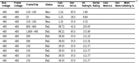

See the attached pic.
What PPE CAT and IE level should I label the 208/120 Panel?

Well, what the study says, HRC 3. However, I would question these results, do you know all the info used for the calulation?

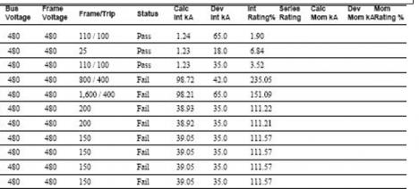

This is what my label would look like. This would be for three phase not single phase.
My calculations does not include your upstream utility data. :)

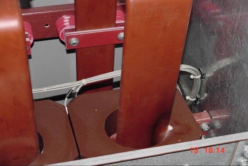

PostPosted: Thu Nov 05, 2009 2:13 pm
Posts: 40
See the attached for more detail, using IEEE 1584 study in SKM. Basically at the max clearing time of 2.0 Seconds.
Since this Xfmr is <125 KVA and it is 208V would you label it any different?

I like the label.. Looks like this is generated from easypower? Do you do a study on all your transformers <125KVA? why 2* rather than 3? Did easy power calc this?
