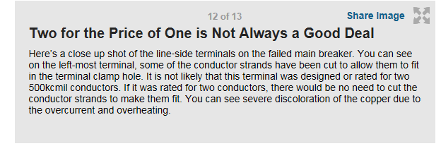

We have been seeing aluminum more and more so much so that in lieu of it being a VE by the contractor, when the project is started this is a conversation with the owner if they are open to the idea it becomes a required bid alternate at bid time, we have found if it comes in as a VE after the contract is awarded it is likely the owner will see a credit although not the same credit you would see under a competitive bid scenario. We see it specified / used in all facilities, from commercial to heavy industrial. Most of the automotive facilities [factories] have standardized on AL IAC in tray for bus duct, etc. Some will even use triplex-Tray Rated AL [XHHW-2] spaced to achieve the free air rating in tray, and most contractors will procure the cable from the distributor this way using colored insulation and pre-plexed on the spool with pulling heads already attached as to make the installation less labor intensive as a way to “sharpen their pencils”, in commercial buildings even the use of riser MC-AL. In most applications we see it limited to 100A and above, some down as far as 60A. As for the lugs not sure if “trimming the hair” is the right approach [I believe there was an article about this in a recent EC&M an investigative article], just being sure when you procure the equipment or are checking submittals/shop drawings you are getting the correct lug kit. Most breaker and panel manufacturers will have more than the standard lug kit available, or you could always utilize aluminum to copper pin-adapters, where lug size or the requirement for copper cable at the termination is an issue [some HVAC / mechanical equipment]. We have found as long as you have a good contractor competent in the requirements for the termination of aluminum cable there have been no issues, some owner allow the use of AL cable with the exception that all terminations are Cu using the associated Al-Cu pin adapters. The one place we have not seen allot of aluminum is in the MV world, still mostly copper EPR or sometimes XLP, however it is changing more and more.
