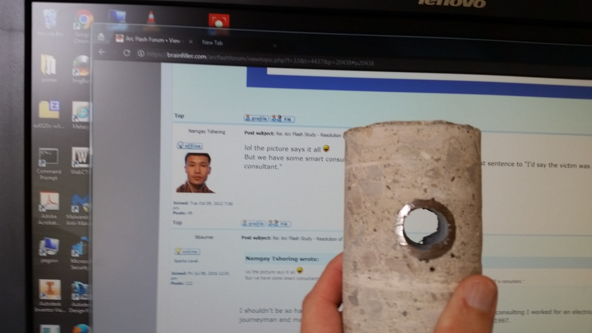

When I tell them not to allow conduit within floor slabs because we've had too many issues with cutting and coring into live circuits down the road they say why don't you just x-ray all your slabs? Yeah, right. Why don't YOU x-ray all our slabs Mr. Consultant.

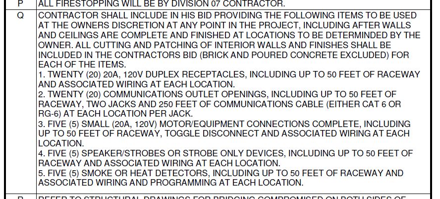

When I tell the consultants to put a general note on the drawings requiring the contractor to include a certain number extra devices to be located later on a new building or major renovation (receps, exit signs, smokes, horn/strobes, comm outlets, small equipment connections etc.) during construction they scoff at the idea. I say I can buy those recepts with the bid for $200 per now or $1200 via change order later with a whole lot more paperwork. Same with temperature control points. We always have to add some recepts, or a smoke detector, or a comm outlet here or there that was missed during design.
