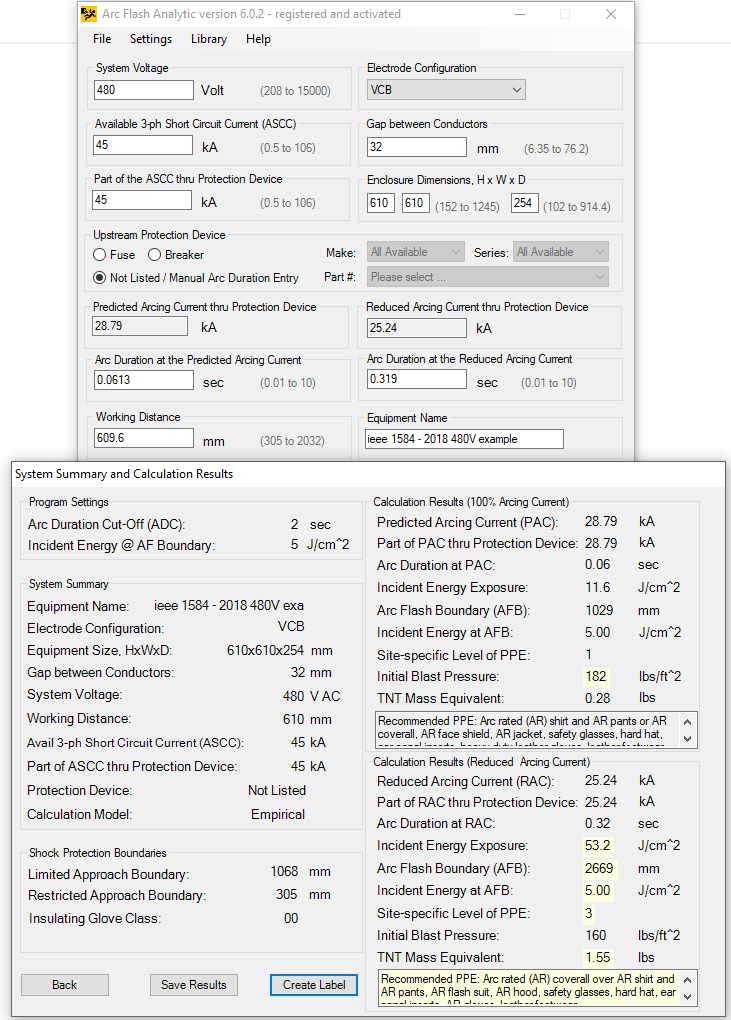

We recently bought a copy of the new IEEE 1584-2018 Version and we are using excell spreadsheets as well , since new softwares will only be purchased next year.If you do not mind ,have you gone through the sample calculations in the new IEEE-1584 2018 Standard ?
On page 74 of the standard, I am getting higher values of incident energy i.e 65.23 J/mm2 instead of the 53.156 shown in the example.I tried checking more than ten times and I see nothing wrong on my spreadsheet.Did you get it right , if yes, then I know Im definitely doing something wrong.

yes indeed you must be doing it wrong. check screenshot below confirming the IEEE 1584-2018 480V numbers.
