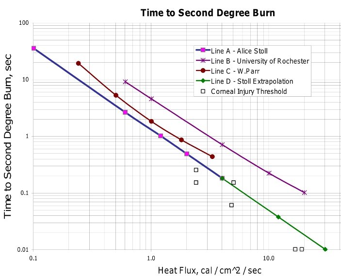

Use of Incident Energy as a Measure of Burn Severity in Arc Flash Boundary Calculations
The IEEE P1584 Standard was developed by having incident energy testing performed based on methodology described in the ASTM F1959-99 standard. The incident energy to which the worker's face and chest could be exposed at working distance during an electrical arc event was selected as a measure for determining hazard risk category and calculating the arc flash boundary. The incident energy of 1.2 cal/cm2 ( 5.0 J/cm2 ) for bare skinwas selected in solving the equation for the arc flash boundary in IEEE P1584 [1584 IEEE Guide for Performing Arc-Flash Hazard Calculations. IEEE Industry Applications Society. September 2002. page 41]. Also, NFPA 70E [NFPA 70E Standard for Electrical Safety in the Workplace. 2012. page 10] states that “a second degree burn is possible by an exposure of unprotected skin to an electric arc flash above the incident energy level of 1.2 cal/cm2 ( 5.0 J/cm2 )” and assumes 1.2 cal/cm2 as a threshold incident energy level for a second degree burn for systems 50 Volts and greater [NFPA 70E Standard for Electrical Safety in the Workplace. 2012. page 26].The IEEE 1584 Guidestates that “the incident energy that will cause a just curable burn or a second degree burn is 1.2 cal/cm2 (5.0 J/cm2 )” [1584 IEEE Guide for Performing Arc-Flash Hazard Calculations. IEEE Industry Applications Society. September 2002. page 96]. To better understand these units, IEEE P1584 refers to an example of a butane lighter. Quote: "if a butane lighter is held 1 cm away from a person’s finger for one second and the finger is in the blue flame, a square centimeter area of the finger will be exposed to about 5.0 J/cm2 or 1.2 cal/cm2 “. However IEEE P1584 equations (5.8) and (5.9) for determining the arc flash boundary can also be solved with other incident energy levels as well such as the rating of proposed personal protective equipment (PPE). The important point to note here is that threshold incident energy level for a second degree burn or onset to second degree burn energy on a bare skin is considered constant value equal to 1.2 cal/cm2 (5.0 J/cm2) in IEEE P1584 Standard.
Flash Fire Burn Experimentations and Observations
Much of the research which led to equations to predict skin burns was started during or immediately after World War II. In order to protect people from fires, atomic bomb blasts and other thermal threats it was first necessary to understand the effects of thermal trauma on the skin. To name the few, are the works done by Alice M. Stoll, J.B.Perkins, H.E.Pease, H.D.Kingsley and Wordie H. Parr. Tests were performed on a large number of anaesthetized pigs and rats exposed directly to fire. Some tests were also performed on human volunteers on the fronts of the thorax and forearms. A variety of studies on thermal effects have been performed and thermal thresholds were identified for different degree burns. We will focus on second degree burn as this is the kind of burn used to determine the arc flash boundary in engineering arc flash analysis studies.
Alice Stoll pursued the basic concept that burn injury is ultimately related to skin tissue temperature elevation for a sufficient time. Stoll and associates performed experimental research to determine the time it takes for second degree burn damage to occur for a given heat flux exposure. Stoll showed that regardless of the mode of application of heat, the temperature rise and therefore the tolerance time is related to heat absorbed by the skin[Stoll, A.M., Chianta M.A, Heat Transfer Through Fabrics. Naval Air Development Center. Sept. 1970]. Results of this study are represented in Figure 1 line (A) along with other studies discussed below.Image
Figure 1. Stoll Criterion Time to Second Degree Burn for Various Incident Heat fluxes on Bare Human Skin
A. Stoll found that the results from her experiments could be predicted using Henrique’s burn integral [Torvi D.A., A Finite Model of Heat Transfer in Skin Subjected to a Flash Fire. University of Alberta. Spring 1992]. Henriques and Moritz were the first to describe skin damage as a chemical rate process and show that first order Arrhenius rate equation could be used to determine the rate of tissue damage.
In 1952, J.B.Perkins , H.E.Pease and H.D.Kingsley of the University of Rochester, investigated the relation of intensity of applied thermal energy to the severity of flash fire burns [J. B. Perkins, H. E. Pearse, and H. D. Kingsley, Studies on Flash Burns: The Relation of the Time and Intensity of Applied Thermal Energy to the Severity of Burns, University of Rochester Atomic Energy Project, Rochester, NY, UR-217, December 1952]. Comparing results of this study with those of Alice Stoll shows that a larger amount of energy is required to induce second degree burn. Results of this study are represented in Figure 1 line (B).
Figure 1 line (C) shows second degree burn threshold as reported by Wordie H. Parr [Wordie, H. Parr, Skill Lesion Threshold Values for Laser Radiation as Compared with Safety Standards. US Army Medical Research Laboratory. February 1969]. The results were obtained by exposing skin to laser radiation and determining dose-response relationship for producing different grades of burns. The Figure 1 shows that the Wordie H. Parr curve lies between those proposed by Alice Stoll and those proposed by the University of Rochester study. The explanation for these second degree burn threshold differences could be interpreted by the fact that thermal injury depends on energy absorbed per unit volume or mass to produce a critical temperature elevation. Skin reflectance and penetration greatly influence this absorption. Also, heat conduction in tissue is far more efficient for smaller than for larger irradiated areas and exposure to higher levels of irradiance would be possible before injury occurred. Indeed, with extensive irradiation, injury would occur at far lower level of irradiance [IPCS. Lasers and Optical Radiation. World Health Organization. Geneva, 1982].
After reviewing these three studies, it was concluded that the curve presented by Stoll is most suitable for evaluating the type of burn hazard expected with arc flash. Stoll's study is a good choice because it is more conservative than the other two studies and therefore minimizes cases where the burn severity for a specific thermal flux exceeds the associated degree of burn, and is less open to criticism.
Figure 1 also includes an arrangement of onset to corneal injury thresholds from CO2 laser radiation (see square markers on Figure 1) [IPCS. Lasers and Optical Radiation. World Health Organization. Geneva, 1982]. The data follows the trend similar to that observed by Stoll and others. The range of scatter in the data is thought to be mainly due to the use of different corneal image sizes.
Stoll’s results can be theoretically extended to include heat flux rates over 40cal/cm2/sec experimentally observed, and they are represented by line (D) on Figure 1. The observed and extrapolated data lines A and D can be expressed analytically as:
t = 1.3 * H^-1.43 ( Equation 1)
where t is time to second degree burn in seconds, H is heat flux in cal/cm2/sec.
As an example of using the Equation 1, the projected time to second degree burn at a heat flux rate of 2 cal/cm2/sec is approx 0.5 sec. During this time interval the skin would be exposed to a total of 1 calcm2incident energy (2 cal/cm2/sec x 0.5 sec = 1 cal/cm2 ) , whereas at 30 cal/cm2/sec flux the time to second degree burn is equal to 0.01 sec resulting in only 0.3 cal/cm2 incident energy exposure, yet inducing the same burn severity as the former less intense and more lasting exposure.

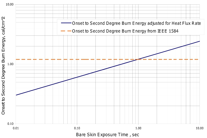

Figure 2 below shows onset to second degree burn energy threshold adjusted for heat flux rate as a function of exposure time. The onset to second degree burn energy threshold was calculated as a product of heat flux rate and time to second degree burn as per the Stoll’s data from Figure 1 lines A and D.
Figure 2 - Threshold Incident Energy for a Second Degree Burn vs. Exposure Time
Figure 2 demonstrates that the threshold energy for a second degree burn injury is not a constant but rather a variable. Note that the 1.2 cal/cm2 onset to second degree burn energy for bare skin used in IEEE P1584, NFPA 70E and CSA Z462 ( dashed line on Figure 2 ) intersects with the curve produced using the Stoll’s data at one (1) second point on Figure 2. This observation supports the choice of Stoll’s curve that we made for evaluating the type of burn hazard expected with an arc flash.For exposures lasting less than 1 second the irradiance required for an injury would significantly increase as the duration of exposure decreased; however, the amount of incident energy required to cause a second degree burn would decrease. Equation 2 shown below is an analytical expression for the threshold line represented by Figure 2:
Eb = 1.2 * t^0.3 (Equation 2)
where t is exposure time in seconds. Eb is threshold incident energy in cal/cm2 that needs to be released during the exposure time t to cause second degree burn.
As an example of using Equation 2 above, consider 1, 10 and 100kA faults in 600 Volt grounded switchgear with one (1) inch gap between conductors. The table below summarizes Arcing Current, Incident Energy and the Arc Flash Boundary (AFB) predicted using IEEE P1584 Empirical Model. We deliberately assigned arc duration to 1, 0.1, and 0.01 seconds for the 1, 10 and 100kA faults respectively which is consistent with inverse nature of typical protective device time-current characteristics. Column F lists AFB values calculated using 1.2 cal/cm2 onset to second degree burn Incident Energy recommended by IEEE P1584 Guide. Column I lists AFB values calculated using onset to second degree burn energy evaluated from Equation 2 and published in column H.
Note that the amount of incident energy the person would be exposed to remains the same and equal to 2.1 cal/cm2 in all three instances (Column D). The arc flash boundary also remains the same when Incident Energy at AFB is assigned 1.2 cal/cm2 value onset to second degree burn energy as recommended in IEEE P1584. Therefore applying same onset to second degree burn energy for the above fault scenarios would make them appear to be of same severity. However, the arc flash boundary drastically changes when incident energy at AFB is being evaluated using Equation 2. AFB will now increase with an increase of the available fault current, predicted arcing current and heat flux released by an arc.
Therefore, using onset to second degree burn energy for bare skin exposure fixed to 1.2 cal/cm2 in calculating the arc flash boundary for arc durations other than one (1) second is, as far as we are concerned, open to dispute and, in our strong opinion, heat flux rate should be factored-in when estimating skin damage imposed by an arc flash. Using the 1.2 cal/cm2 energy for exposure times less than one second will result in undervalued arc flash boundaries while resulting in conservative but save arc flash boundaries for exposure times more than one (1) seconds. As the IEEE 1584 Guide states, the Guide’s equations (5.8) and (5.9) [1584 IEEE Guide for Performing Arc-Flash Hazard Calculations. IEEE Industry Applications Society. September 2002. page 13] can be used to calculate the arc flash boundaries with boundary energy other than 1.2 cal/cm2, and we believe the equations should be in fact solved for boundary energy computed using the Equation 2 especially for cased when arc duration is less than one (1) second.

sorry, the equation 2 should actually read Eb = 1.2 * t^0.3

Found it. Your analysis is mostly correct above 1 second. Some additional data circulating out there suggests at very long time intervals (>10 seconds) there are additional problems but since most folks use a cutoff below that point it suffices to say that the "very" extended range case does not matter.
Below 1 second, data from Privette shows what I described...the Stoll curve increases rather than continues to decrease. Although it is an indirect reference, see "Protective Clothing Guidelines for Electric Arc Exposure", IEEE Trans. on Ind. Applications, V 33, No. 4 (1997), pp. 1041-1054). Authors are Neal, Bingham, and Doughty.
The reasons for this and references are given as well. Above 1 second, I agree pretty much with what you are describing...that the 1.2 cal/cm^2 "cutoff" is not a constant. I would caution you though that this is all assuming that the incident energy is purely thermal which testing done by Mersenne has shown that this is not always the case.
