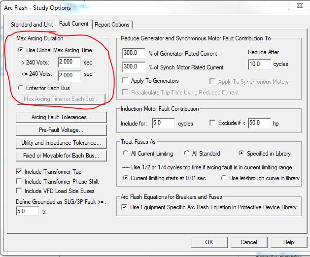

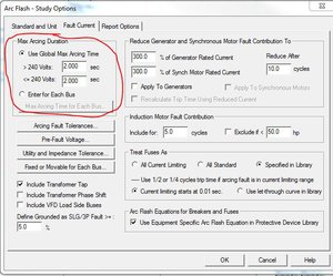

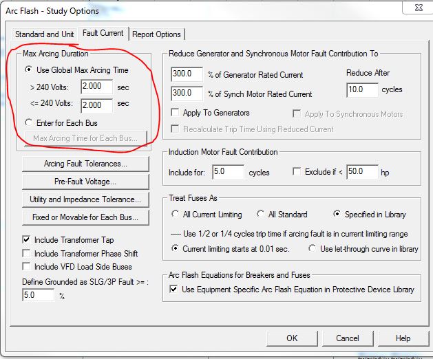

Sorry I can't help you but 200?
Are you using the "2 second rule" and still that high?
 Post subject: Re: Transformer Impedance
PostPosted: Fri Sep 14, 2018 12:42 pm
Joined: Mon Aug 20, 2018 12:27 pm
jmoore284 wrote:
It is an older transformer...not far away from being replaced. It is set to it's lowest possible tap setting of 12.54 kV for the primary but is being supplied with 12.47 kV. I do have nameplates for each can identifying the impedance's as I listed them. There is a couple calorie difference on my low voltage switchgear when I model using the lowest imp versus modeling the average imp. Not a major deal since both are around 200 cal/cm2. I'm just really curious what is the correct method.
Yes, 200.3 cal/cm2 to be exact and with the 2 second rule. These values are seen at the low-voltage switchgear which is directly connected to the secondary of the transformer. Luckily, in this case we just replaced the switchgear and all buckets have ARMS. With ARMS activated I can get the IE down to 4 cal/cm2 for all feeder buckets.
