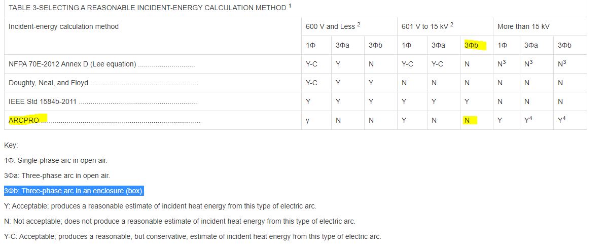

I am performing an arc flash study on a 15kV utility distribution system and would like to hear thoughts on what configuration a 15kV deadfront switch would qualify as?
(https://www.eaton.com/us/en-us/catalog/medium-voltage-power-distribution-control-systems/pad-mounted-most-oil-switch.html)
I understand using 1584 it would be Horizontal Enclosed but could the case be made that a fault would result in a single phase to ground and use ArcPro for the analysis?
Thanks,
Ozro

I would use ArcPro. There will be no 3Ø faults on deadfront equipment.
 Post subject: Re: 15kV Deadfront Switchgear - Single or Three Phase?
PostPosted: Mon Nov 25, 2019 9:24 am
Per OSHA, they do not recommend the use ArcPro for enclosed 15 kV switchgear
See 1910.269 - TABLE 3—Selecting a Reasonable Incident-Energy Calculation Method

Robert, I was planning to use ArcPro only if the justification could be made that three phase arcs were not likely to occur in deadfront SWGR. If I am reading that table correctly, OSHA accepts using ArcPro for single phase calculations at 15kV.
PostPosted: Tue Dec 03, 2019 2:42 pm
Ozro wrote:
Thank you both for your replies.
OSHA requires that you use 3 Phase bolted faults for enclosed equipment. They allow you to use ArcPro (using line to ground fault current) and then use "with multipliers" to increase the AF energy to a supposedly equivalent 3 phase value. I have done a lot of research and contacted many other engineers and nobody seems to know what the multipliers should be.
On 208 to 15 kV systems, I would recommend using IEEE-1584-2018 to determine the AF energy and boundaries for both open and enclosed equipment.
In ArcPro 3.0, just choose your fault type from the drop down. 3 phase AC enclosed is one of several choices. In 2.0, the factors are listed in the help file. Unfortunately, the range is large for some.
1 phase in a box 1.5
3 phase 1.2 to 2.2
3 phase in a box 3.7 to 6.5.
