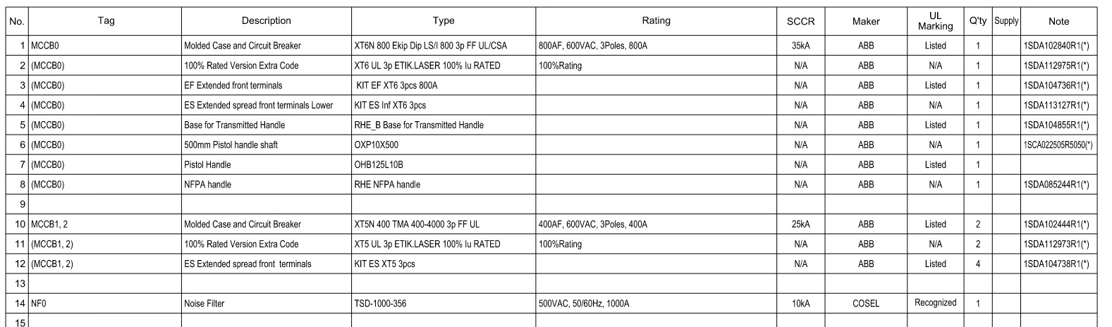

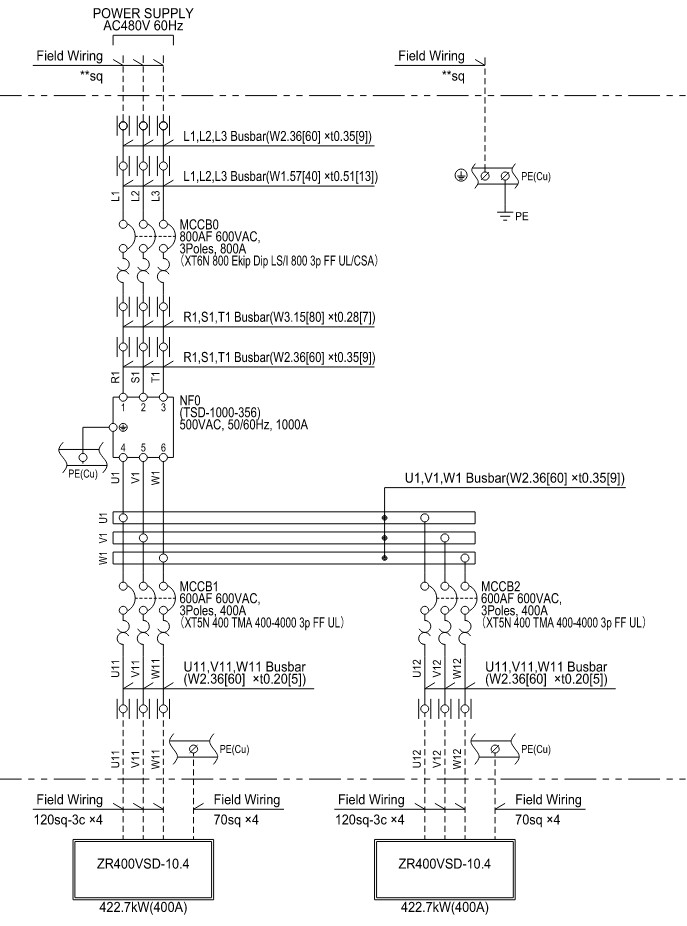

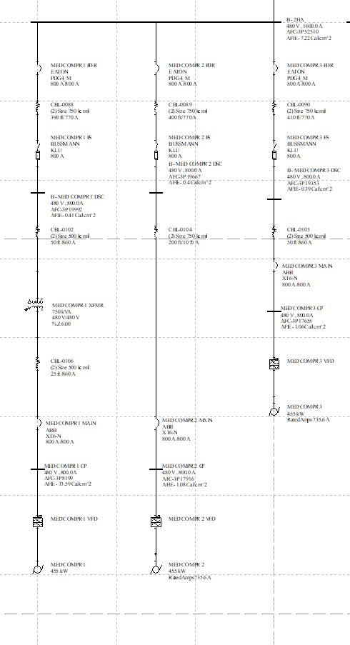

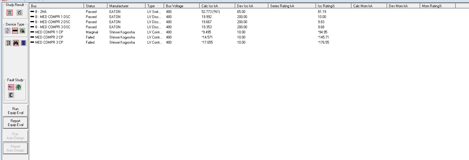

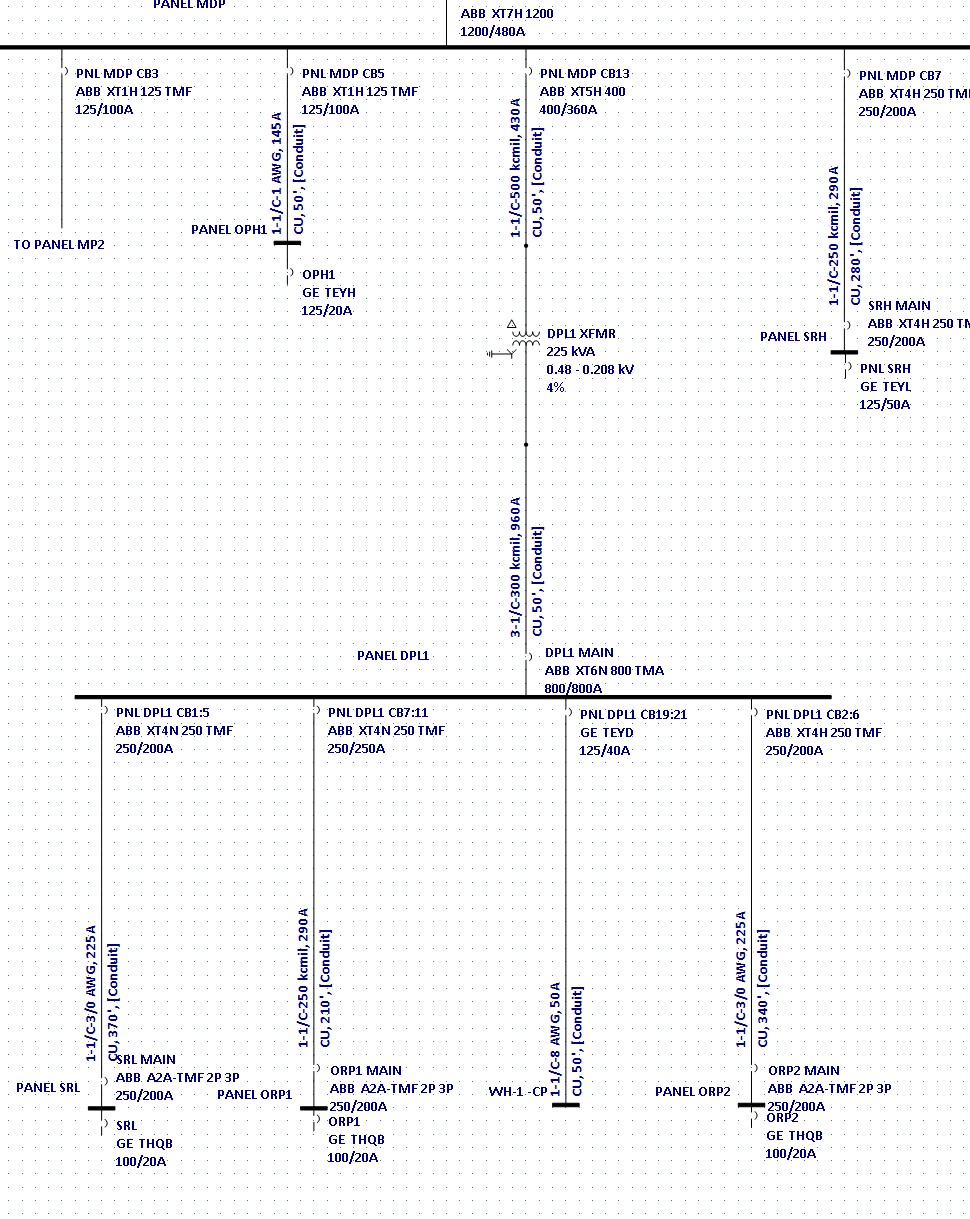

The SCCR rating on the control panel's nameplate is 10kA, which is why my equipment evaluation is failing. Bussman KLU 800A fuses are utilized in an 800A fused disconnect that supplies the control panel with two 500 kcmil at a distance of fifty feet. An ABB XT6-N 800A main breaker with an AIC rating of 35K is located inside the control panel.
I've been looking for a way to reduce the fault current to less than 10kA. Adding a 750 KVA transformer after the disconnect was the only fix I could find.
Is there something I'm missing?
File comment: Panel Diagram
File comment: Equipment Evaluation
Medium Pressure Control Panel Oneline Equipment Evaluation.jpg [ 79.84 KiB | Viewed 17263 times ]
File comment: Oneline with the option for a 750 KVA Transformer.
File comment: Bill of Material

Did you model the drives to allow motor contribution through the drives? If they aren't regenerative drives and don't have bypasses or have bypasses that won't be used or can't be used without damaging the compressors or the process they are part of you could check or uncheck the boxes that allow motor contribution and see what that does. Probably will help some but not get you there. I looked up the noise filter and it says it is for applications using regenerative drives so you may be stuck if that is what you have. If you are allowing fault contribution through the drives, does the noise filter impedance have an effect on motor fault contribution? You'd have to model those to, to figure that out.
I don't see the sccr/withstand rating on the filter data sheet: https://coselusa.com/wp-content/uploads ... _TSD-S.pdf but I do see that rating on this page: https://www.cosel.com/en/product/noisefilter/TSD and here: https://www.cosel.com/en/lp/lineup/appl ... index.html
I spent enough time looking into it but it seems as though Cosel has had some of their filters tested in combination with some breakers and if they haven't the "assumed" value for that filter size is 10kA. Here is another link on this if you want to research further: https://www.cosel.com/en/coselplus/technical/111
Is this an existing installation or new design?
Reactors are another option.
Artificially increasing feeder length could be another option but I expect it would border on ridiculous.
Can you reduce the 2 sets of 750's to 600's or 500's or is voltage drop an issue? Your feeders are pretty long. Reducing those 750's to something smaller would help.
If this is a new project, could you locate B-2HA closer to the compressors and make it's feeder longer and the compressor feeders shorter? That may help or may make it worse. I don't know without modeling it.

B-2ha is existing. The medium compressor control panel and fused disconnect is new installation. The original feeders is (2) 500 kcmil at 50 feet. I was just changing the feeders to different types to see if it would make a difference. This is all I have for the compressor data.

Try using something other than a KLU fuse. I often found some Class L fuses to be have differently. I would typically look at fuses from Ferraz as an option.
It all depends on the TCC and your arcing current. Many times these large fuses were originally selected so they would never "blow".

UL listed AIC ratings, for molded case breakers, are derived from actual testing by the manufacturer. UL and the NEC say that all series ratings for AIC must be tested combinations of specific breaker-breaker or universal fuse-breaker.
There is no provisions for any person, including an engineer, to field derive fuse-breaker series rating for pretty much any UL Listed breaker in the past 25 years. The NEC provision for engineering series ratings requires the engineer to guarantee the downstream breaker will remain closed for the entire duration it takes the upstream fuse to clear. this means the breaker cannot have an Inst trip function. The NEC allowance is usually only applied to Power style breakers, like the old iron frame units, built in "drawout" switchgear before the mid-80s when series rating were first introduced.

A recent fault study by a major supplier/manufacturer of electrical equipment noted that the fault level of a 5kA labeled control panel is 8kA so the answer was..."install current limiting fuses upstream"
And that was the final answer.

I can believe that, but it is still dependent on the specific breakers. For various reasons manufacturers do not publish every series rating in publicly available literature, so they need to be contacted.
Most all breaker built to UL489, since, 1985ish, have had series rating with any Class R fuse below 200A and sometimes a little higher.
Very few devices are built exactly to the UL test point of 5kA, 10kA, 22kA, etc. This is one reason series ratings are fairly easy to obtain. I know of one manufacturer whose 120V breaker independently tested to 18kA, but because that is not a UL break point it can only carry a 10kAIC rating.
