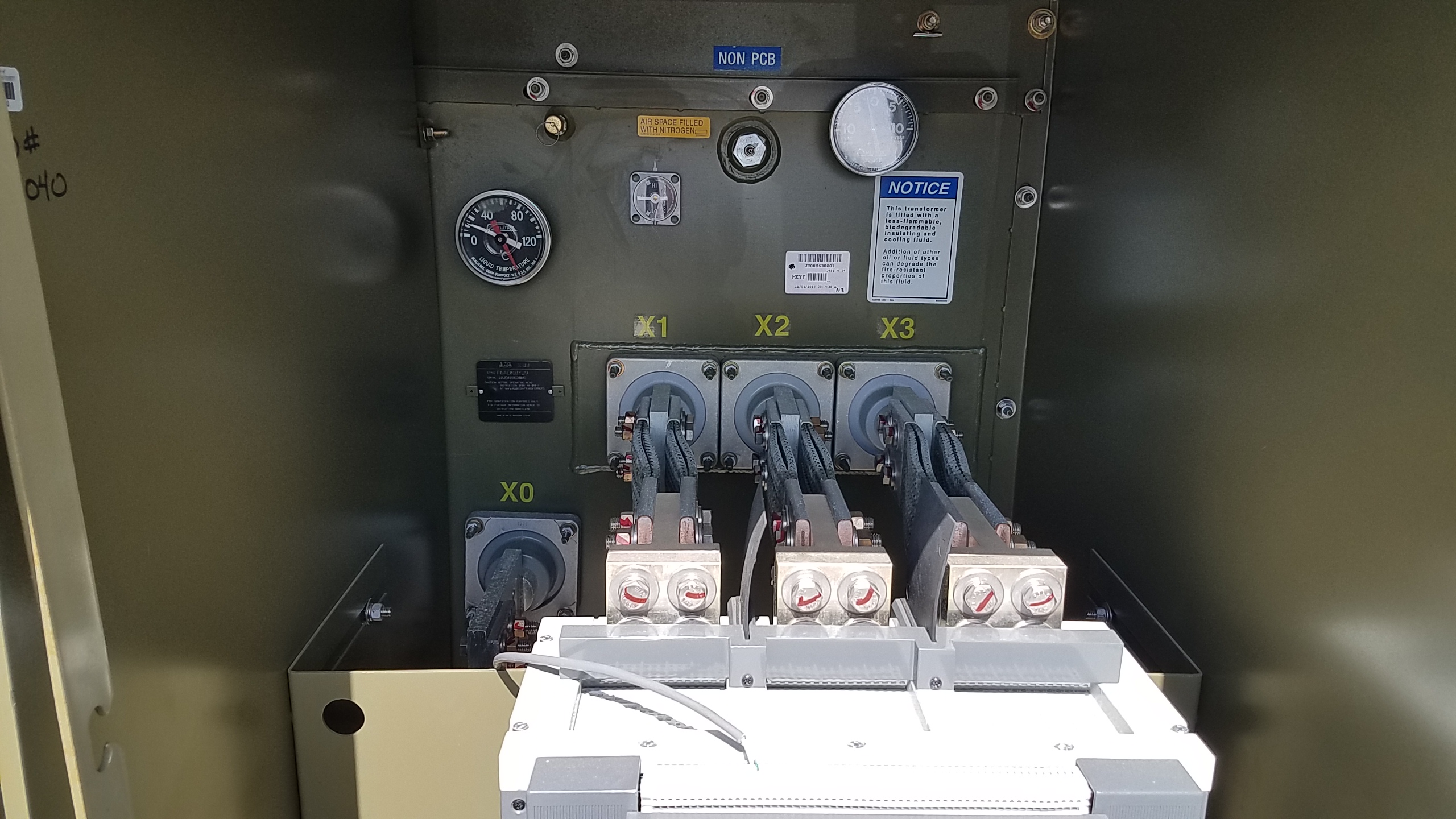

The secondary bushings are all in line, horizontal for the phases as opposed to staggered or offset, and much closer spaced than in a pad mount without a breaker.
What would you call this configuration? HCB?

In my opinion, the first configuration is Hcb. The second is VCBB.

I agree. First one is HCB, second is VCBB.

I too agree. HCB for the first photo and VCBB for the second.
