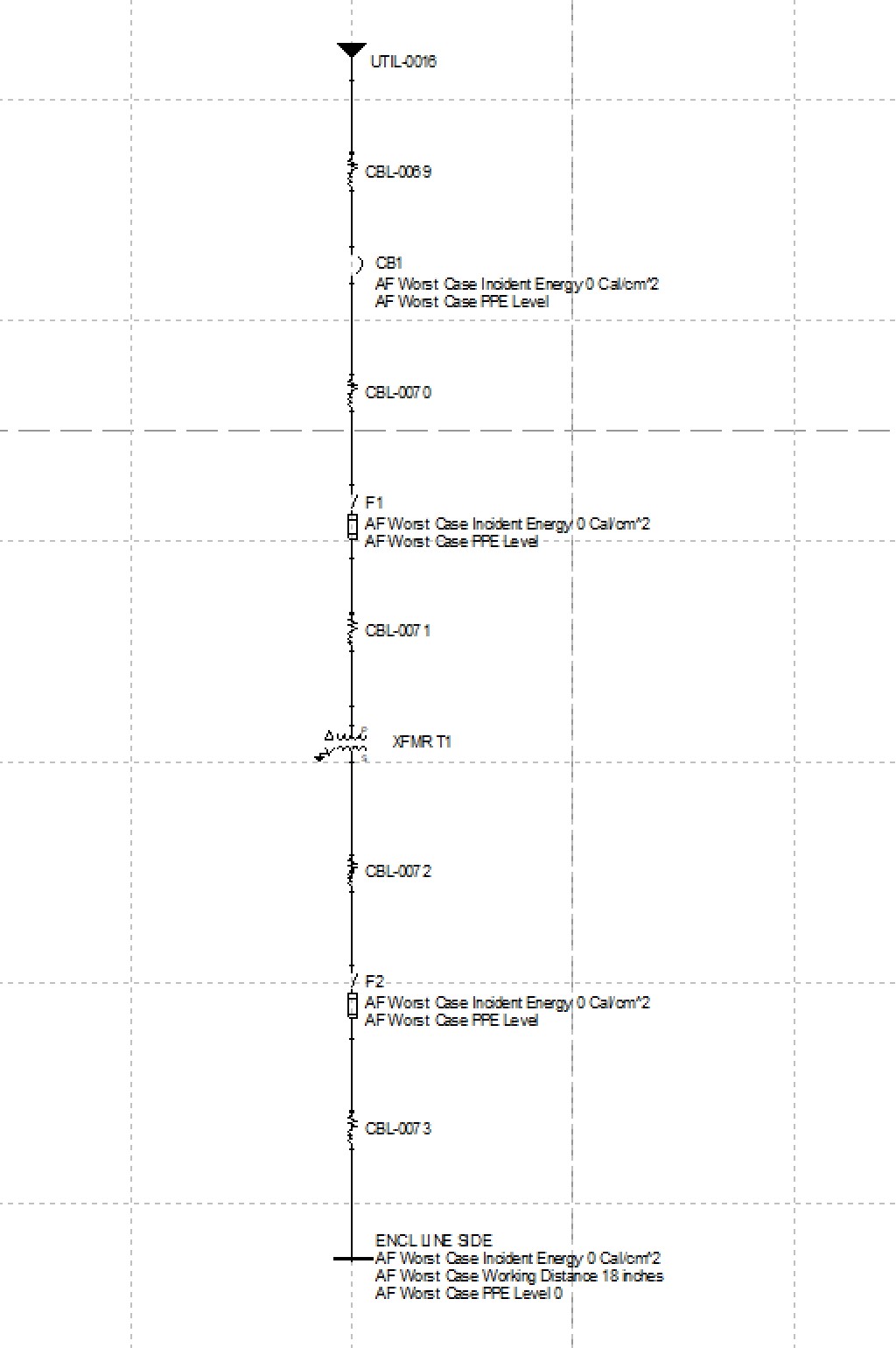

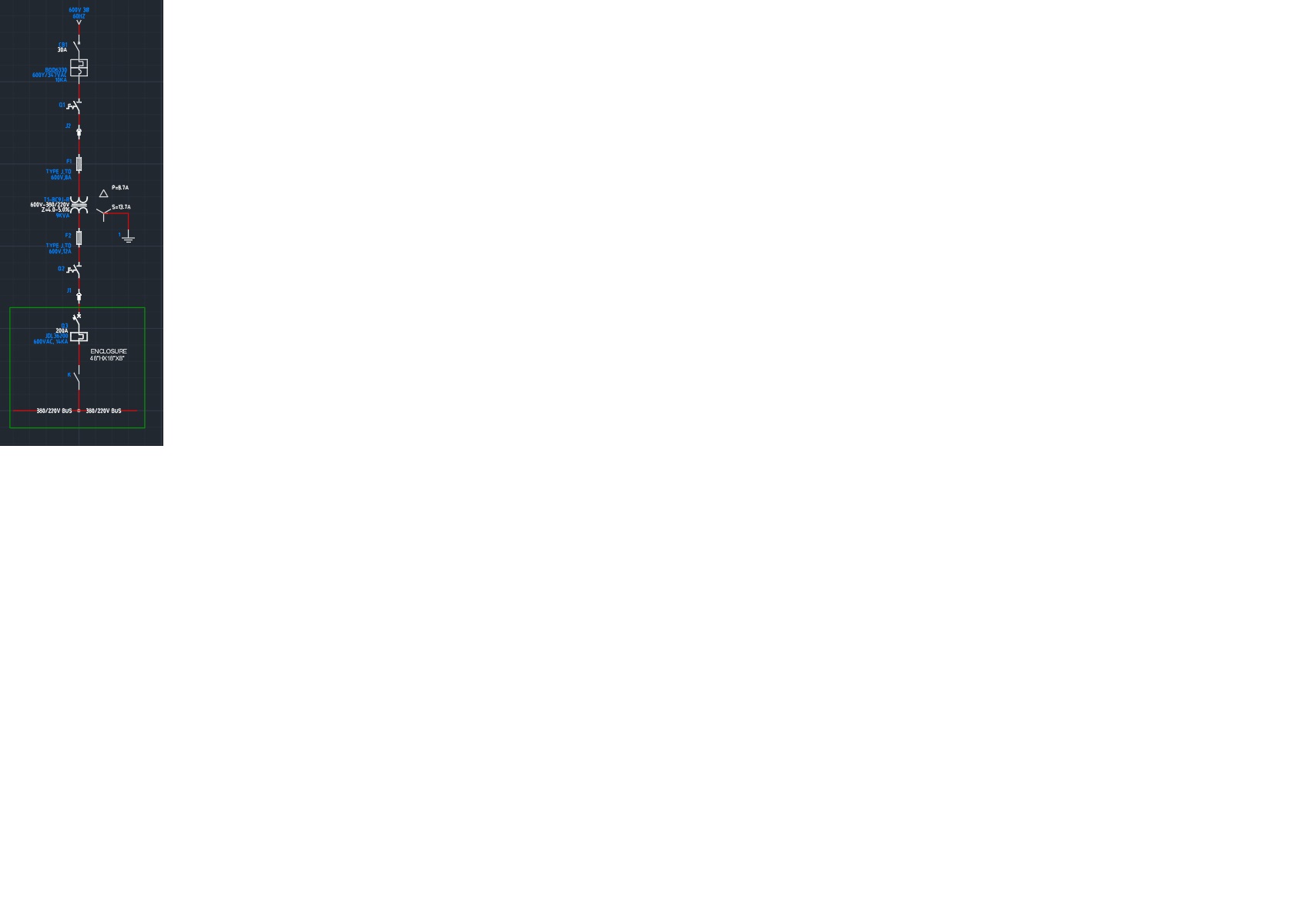

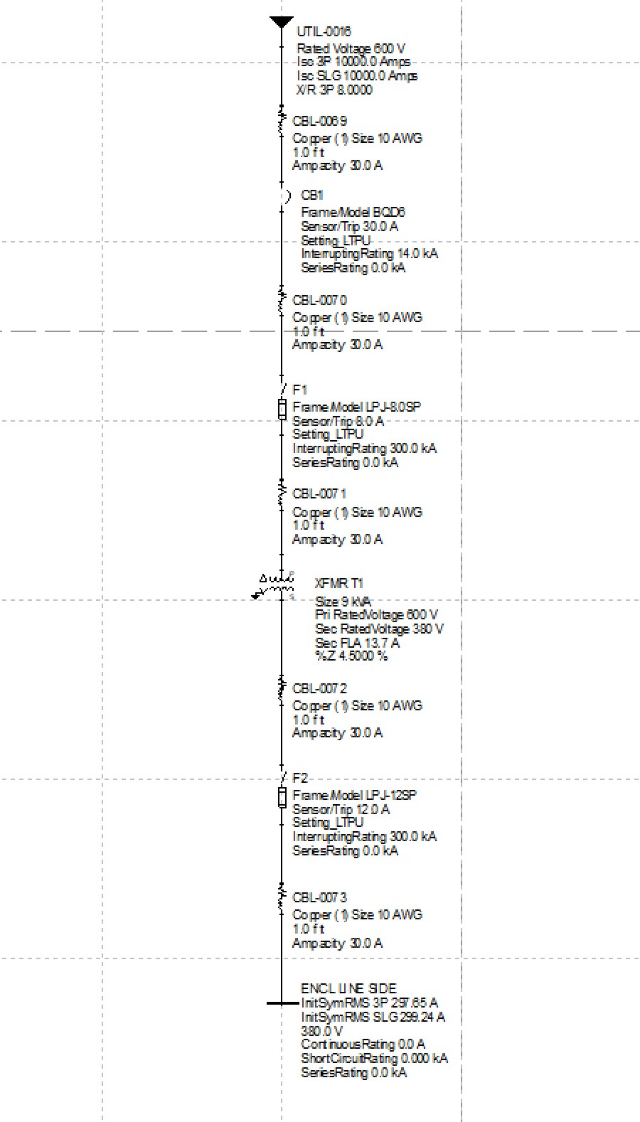

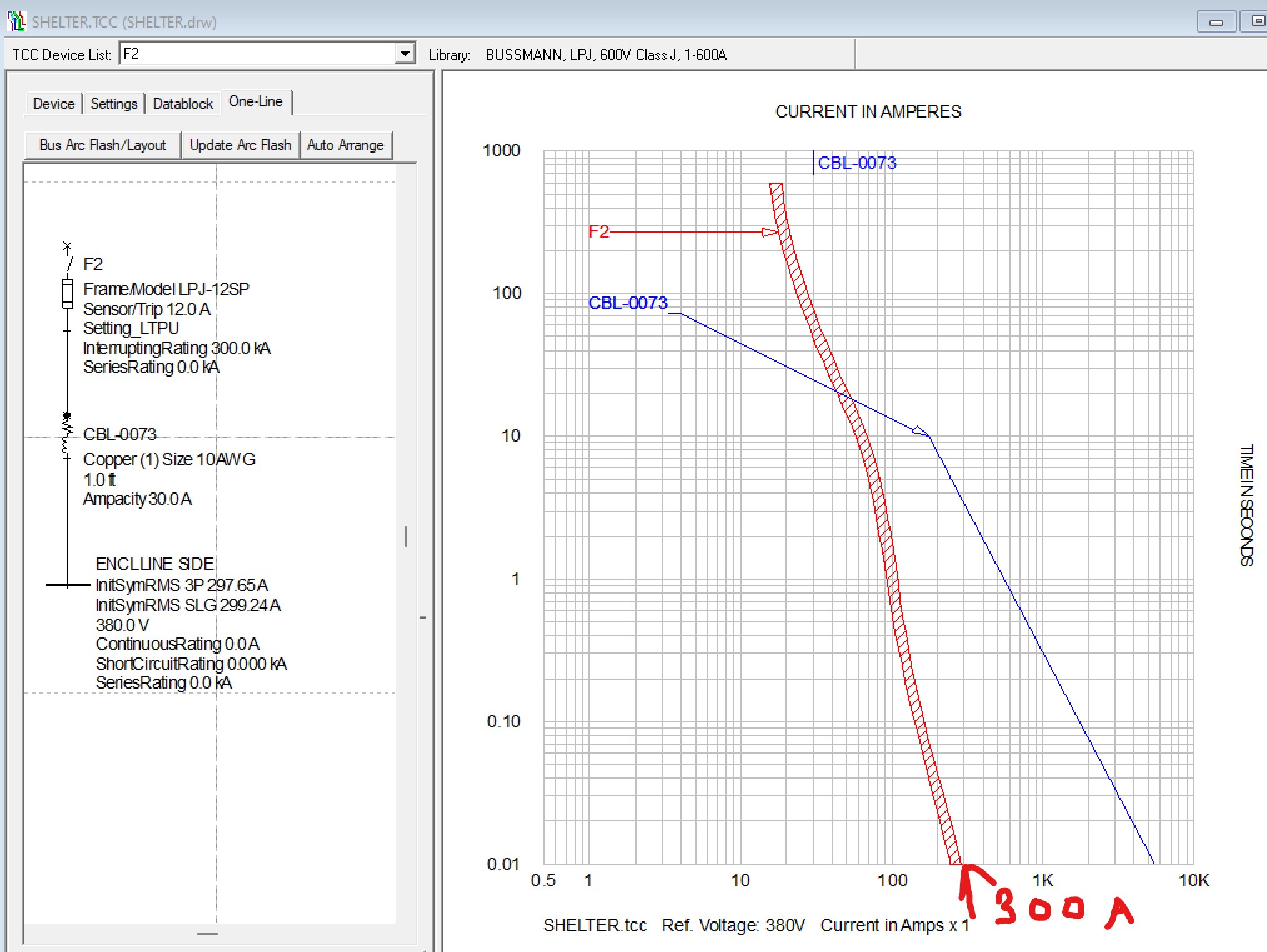

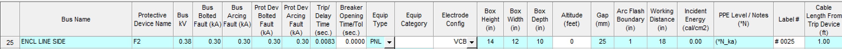

I don't know your available fault current, your proposed cable sizes or lengths, your proposed exact fuses, etc. so I am guaranteeing nothing about the screen captures below. SKM does confirm however that with such low fault currents, and your 12A fuse blowing very quickly, IE is likely extremely low.
