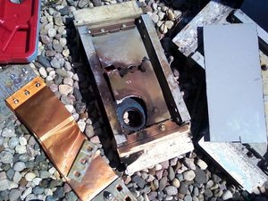

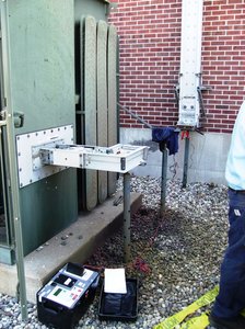

That all being said, I personally believe that it is possible to design a plug-in arrangement where both shock and arc flash hazards can be eliminated during insertion or removal. If the stabs are spaced out where they cannot contact each other even if two of them are folded over, and the areas where the mating surfaces are at are all insulated, and keeping up with other designs, shutters are used to eliminate shock hazards, and there is a disconnect mechanism (mechanically interlocked to the shutters) on the line side. The sole remaining issue is that when the disconnect is closed, if not all stabs are electrically good connections, an arcing fault can still occur where a pin does not seat solidly into the socket. It may be possible to even design a mechanical interlock to prevent this but I'm going out on a limb here. If all of these precautions were taken then I can agree that ANY stab mechanism, not just limited to busway, can be made where I would argue that section 130.1 of 70E does not apply and that this is just operating equipment, not energized work,under the condition that if an arcing fault were to occur, it would be great enough to not satisfy condition #1 above (not above 1.2 cal/cm^2 or equivalent). This is the most conservative approach. However once you back away from this I would agree that some equipment can be provably shown to be reliable enough to not require this much. But don't fool yourself into thinking that just because there is no shock hazard that an arc flash hazard doesn't exist. And even if it does, it is not carte blanche enough to mean that it falls under 130.1. The definition of an arc flash hazard in 70E includes terms related to the likelihood of occurrence. 70E does not define this numerically because it is industry specific. But if you know your acceptance criteria then in some cases some of the more reliable equipment could be considered acceptable because the likelihood of an arc flash is no more than other comparable serious accidents and fatalities. I would argue though that in the case of data centers, the incident rate of serious injuries is pretty low, so the incident rate for arc flash should be comparable, and well below national averages.
