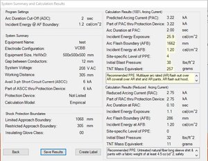

Posts: 45
Here's it's more intuitive.

Posts: 45
Isc (transformer Isc) = 6971A
Posts: 45
