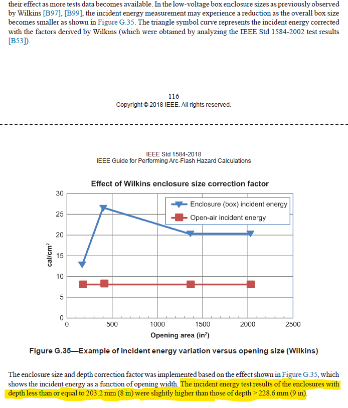

I've also just read a statement in IEEE Std 1584-2018 Annex G (G.9.4) which that states that Incident Energy test results were higher for enclosures with depth <= 203.2 mm (8 in) than those of depth > 228.6 mm (9 in). Is that a typo?
Here's a screenshot of the aforementioned excerpt...
File comment: Annex G.9.4 of IEEE Std 1584-2018

 Post subject: Re: Why do Shallow enclosures produce a lower Incident Energ
PostPosted: Sun Jan 08, 2023 4:21 pm
Hum.... (official response :lol:)
I'm going to need to look into that one.

Happy New Year Jim and many thanks for your responses.
I hadn't considered that the sides would have less of a focusing effect in a shallow enclosure. That makes good sense.
Thanks for looking into the G.9.4 statement.
