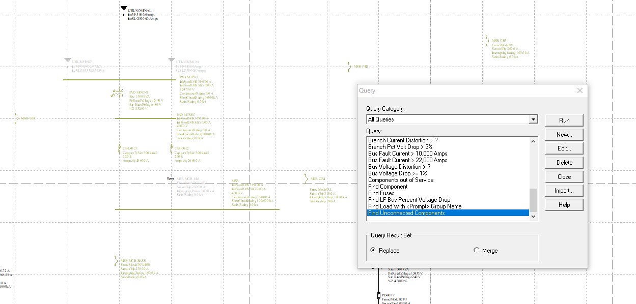

Hi there,
We got an SKM model from the client that has hundreds of buses not connected, abandoned in the model. At the same time these buses name is very similar to other buses in the system that we are going to use in our study.
Is there an easy way to identify these "ghost" buses and get rid of them, something like a purge function?
Thanks,
Alex

I looked at this a bit this morning.
You can right click anywhere in the one-line then do a Query on unconnected components and Run. It selects all the unconnected components that way. Right click again and destroy. That will destroy them all in a oneline. If your model has multiple onelines then you repeat for all oneline drawings.

I've seen this before from previous studies. The times I encountered it the buses existed only in the project database and not in any onelines. I used "Find" > "Find not in one-line" to seek and destroy.
