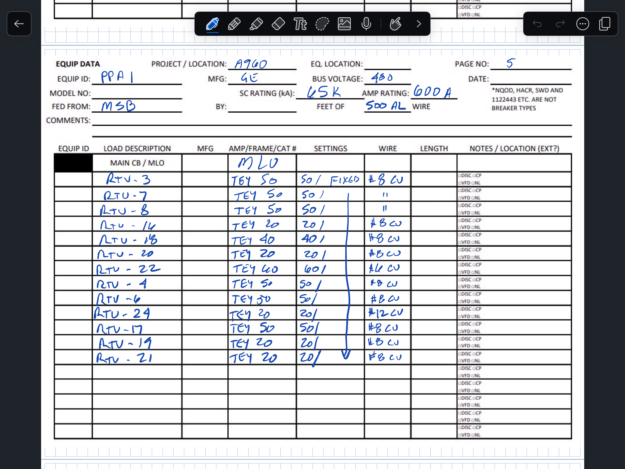

If it is a small job and I have as-built drawings and submittals I normally model it first before I go to collect/verify the data and just work off a hard copy printout and mark it right on the drawing.
If I don't have any drawings or it is too large to work off plots of the model I use a Notability on my ipad.
Examples below. I don't use the SKM mobile version. Never even checked it out. Probably should.

This is weird. The preview thumbnails don't match the pics. If you click on the pics they are correct though.
