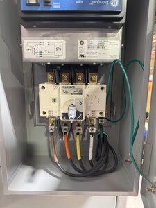

Do you model Surge Suppressor devices?

Its line terminals should be modeled as a bus.

Do I need to add a Protective Device?

No.
