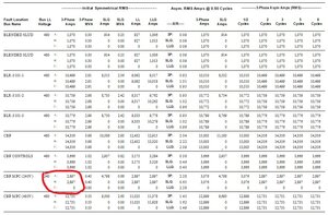

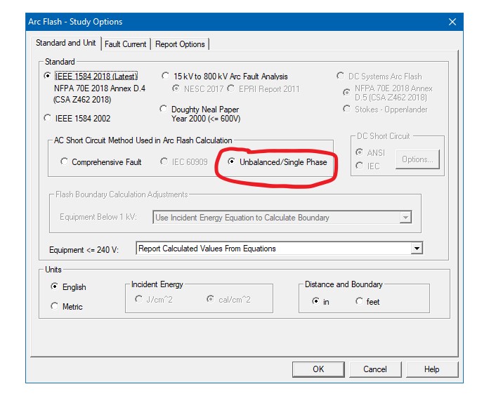

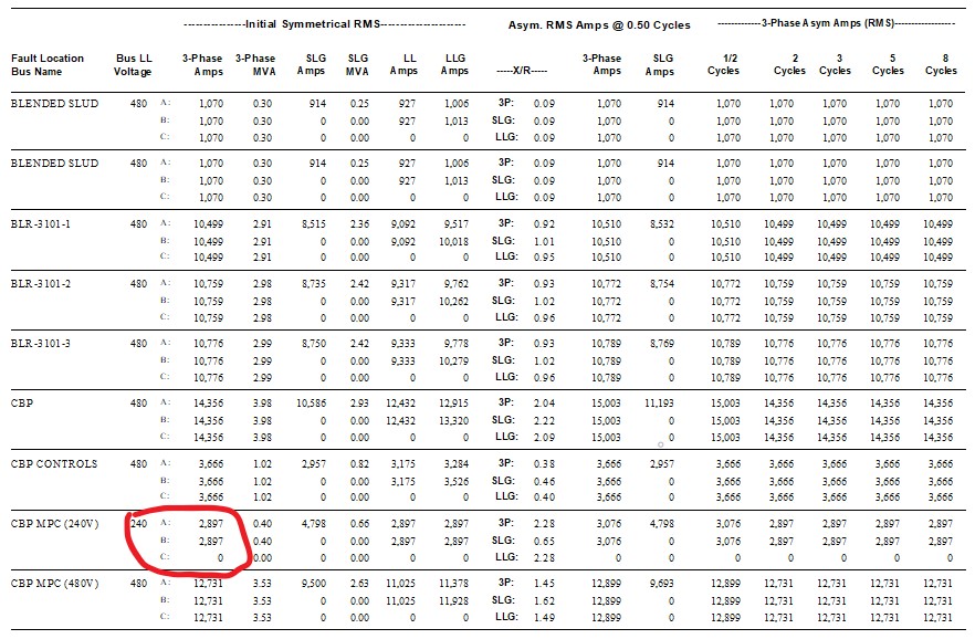

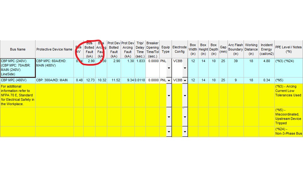

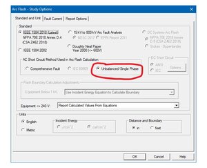

You can use unbalanced/single phase to calculate AFIE results. It is an option in the Standard and Unit tab in the Arc Flash - Study Options. You must be logged into DAPPER, Arc Flash, and Unbalanced single phase to do so.
However, what it really appears to do is take one of the phase currents and uses it as a 3 phase bolted fault as a starting point to calculate AFIE. It also states per note *N24 that it is a non-3-phase bus.
