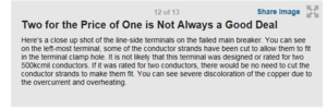

mike01 wrote:
not sure if “trimming the hair� is the right approach [I believe there was an article about this in a recent EC&M an investigative article],
Posts: 48
Location: Mid-West
