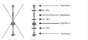

Joined: Mon Apr 09, 2018 10:31 am
Also, note that the bus definitions they use is not the typical bus definition you might be used to. EG. a distribution or panel bus is considered a bus, but also each node between equipment in series, but connected with different impedance.
Ex. example pic below from their website.
Recommend following the website to confirm, but I wanted to point this out.
