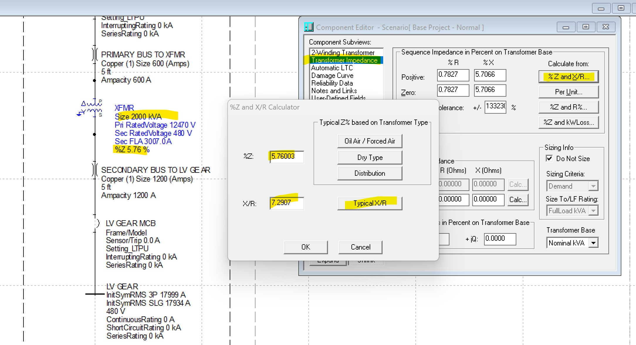

PostPosted: Thu Jan 08, 2026 2:09 am
I'm not familiar with that IEEE document nor am I sure what your voltages are or if it matters but I used the %Z and X/R function on SKM and clicked on Typical X/R and got the same exact value as in your old study. My assumption here is that SKM may be using whatever is in that IEEE doc for this function.
