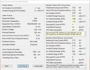

PaulEngr, and others,
75,000/240/0.02=15625 amp
kVa = 75,000
voltage =240v
Input the same data.
Why is it much lower?

PhilEngr, any ideas?

Isc (transformer Isc) = 6971A
Posts: 45
