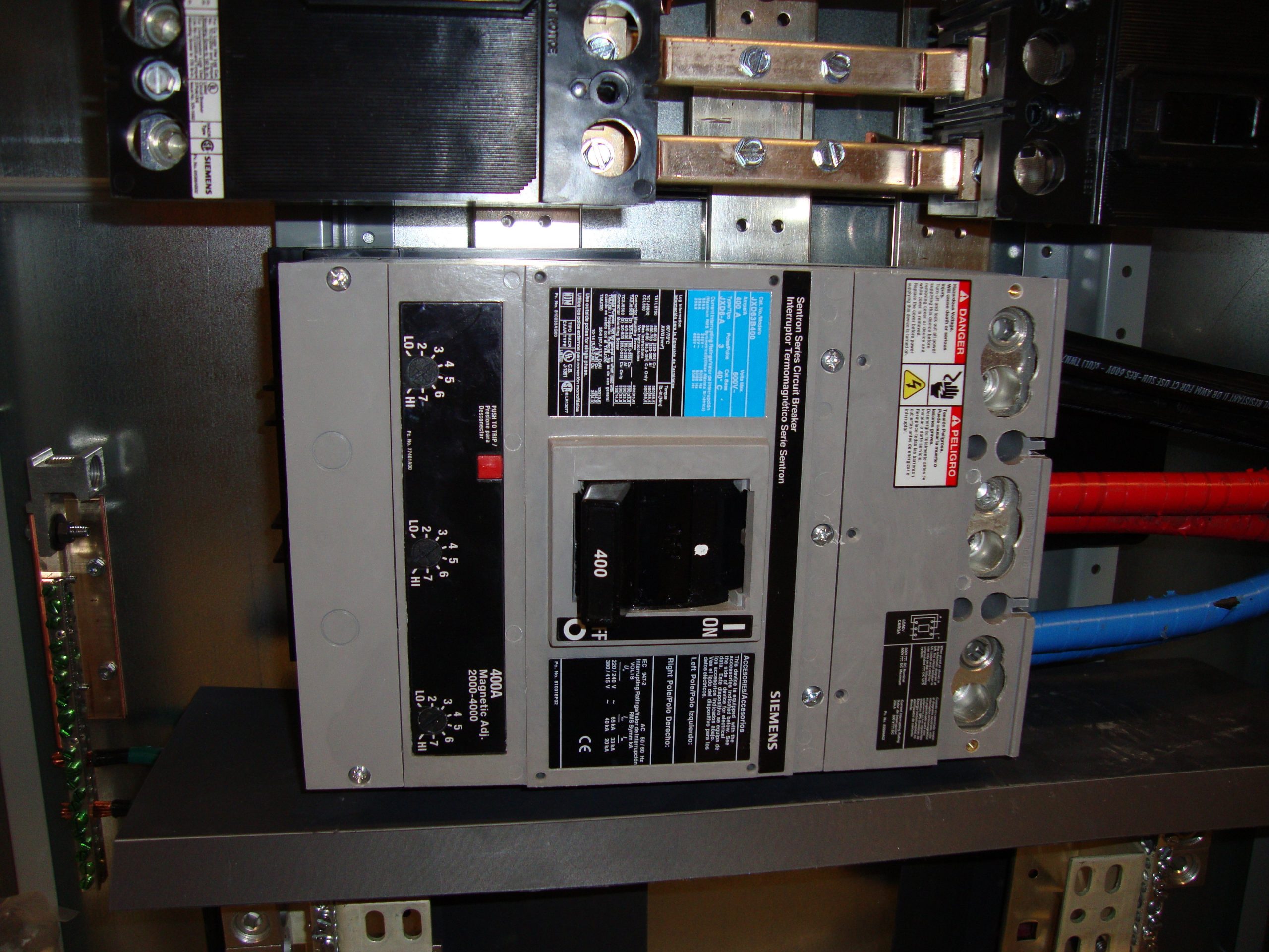

The circuit breaker just tripped. Production is down, alarms are sounding in the background. Panic time. For many, this scenario would mean quickly re-set the circuit breaker and “see what happens.” Not the best idea – the question needs to be asked – why did the circuit breaker trip? This situation can become an even larger problem if the circuit breaker has setting adjustments. Before I go any further, let’s back up a few steps.
Many circuit breakers have setting adjustments that can be used to define how the device responds to short circuit currents. Adjustable circuit breakers as a minimum, will have an adjustable instantaneous setting that defines the level of current where it will trip with no intentional time delay. a.k.a. instantaneous trip. If the abnormal current exceeds this current level, the device trips instantaneously – if the current is less than this level, it will trip in the time delay or overload region.
Other more complex devices such as electronic trip and digital breakers can have a multitude of settings that are used to define an elaborate tripping characteristic. The preferred method for determining the settings for these devices is to perform a coordination study. This requires that the various protective device in the electric power system be analyzed to determine how they should be set so only the device furthest downstream nearest the load trips in the event of an abnormal current. This allows the other devices towards the source to remain closed and results in the minimum amount of an outage.
However, there is another objective and that is to ensure that the protective device also responds quickly enough to provide suitable protection of the conductors, transformers, motors and other electrical equipment. The recommended settings should take into account both selective coordination and protection.
As mentioned, when a protective device trips, often the first response is to simply reset it and see what happens. More often than not, if a breaker tripped once, it will probably trip again because simply resetting it did not solve the root cause of the problem. The second time the device trips, many “experienced” people will increase the setting thinking that it tripped because the setting was too low and not considering why it tripped. Changing a device setting without proper analysis of its impact could reduce selective coordination with other devices and quite possibly reduce the level of protection.
Increasing a protective device setting can create a potentially larger and more dangerous problem – Increasing the Arc Flash Hazard! Depending on the arcing short circuit current that could flow during an arc flash, increasing a protective device setting may cause the protective device to take longer to trip during an arc flash. The amount of incident energy from an arc flash is directly proportional to the duration which is defined by the time a protective device takes to operate. An increase in the device setting does not guarantee it will take longer to operate but it could happen. A detailed analysis of the effect that the circuit breaker setting change has on the arc flash hazard is necessary to know for sure.
As an example, let’s say a calculated incident energy is 5.4 calories/centimeter2 (cal/cm2) and the protective device takes 3 electrical cycles (3/60th of a second) to operate. If a setting change causes the device to now take 15 cycles (15/60th of a second) to operate, the incident energy would increase by a factor of five to 27 cal/cm2!
