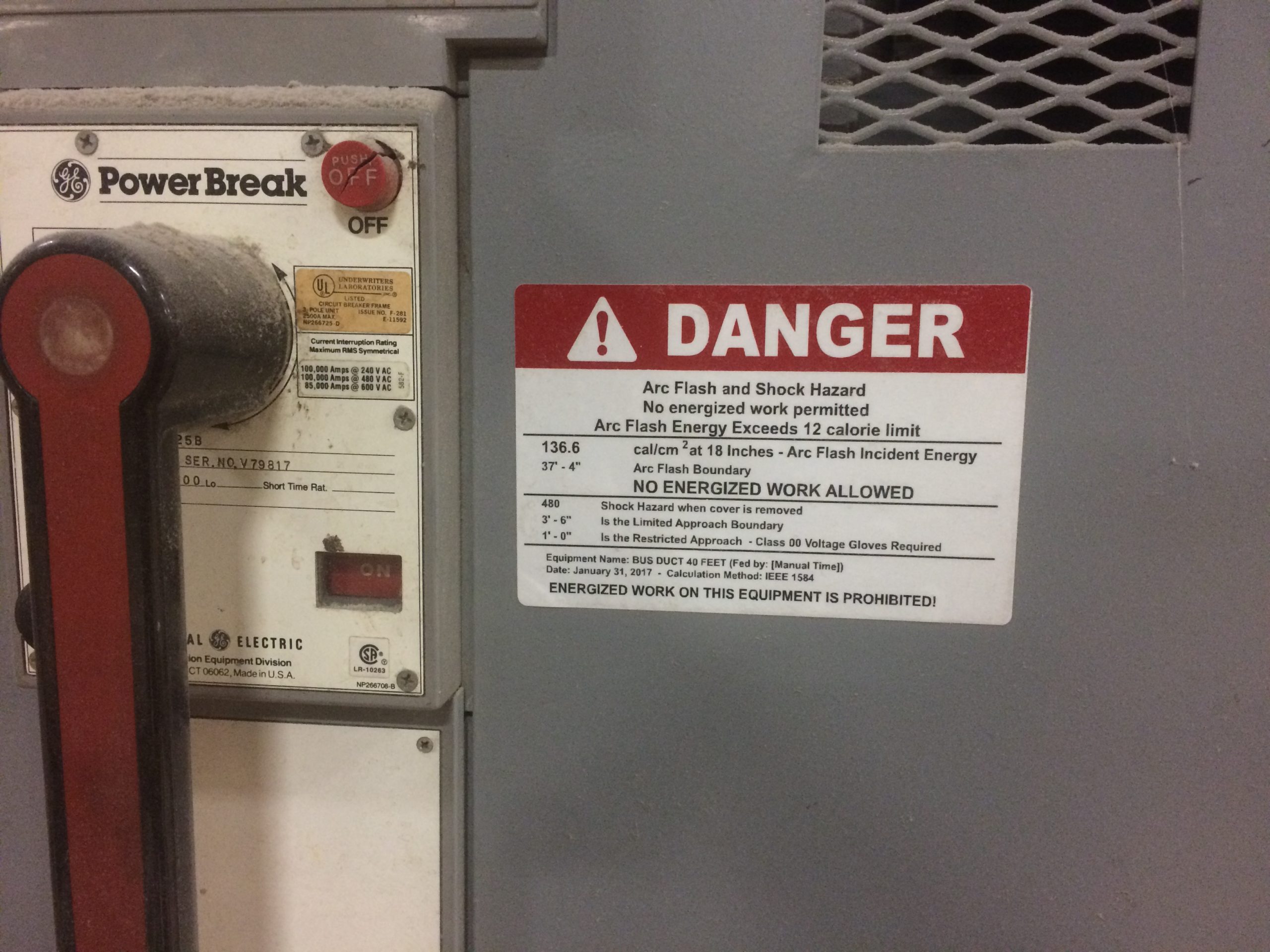

It is amazing how the requirements for arc flash labeling have evolved with each new edition of NFPA 70E. Known as Arc Flash Warning Labels by the National Electrical Code and Equipment Labels according to NFPA 70E 130.5(H), most people simply refer to them as arc flash labels.
What first began as a simple requirement to warn people of the arc flash hazard, has morphed into a list of NFPA 70E Arc Flash Label Requirements found in NFPA 70E 130.5(H). As an example the evolution of label requirements (sometimes referred to as arc flash stickers) was the information to aid in selecting Personal Protective Equipment and Arc Rated Clothing. In the past, the requirements began with Hazard Risk Category Tables, then it became using the Hazard Risk Category Tables OR the calculated incident energy. Today the Hazard Risk Category Table is now the PPE Category Table and there is an array of options listed in 130.5(H). Another evolution was with the term originally known as Flash Protection Boundary. It was later changed to Arc Flash Protection Boundary and finally to Arc Flash Boundary. It is interesting to look at labels today and see what term is being used. You still see some of the earlier terms but regardless of terminology, the Arc Flash Boundary remains as the distance (approach limit) from an arc source where the incident energy is 1.2 calories/centimeter2 (cal/cm2). This is boundary is for the case when an arc flash hazard exists.

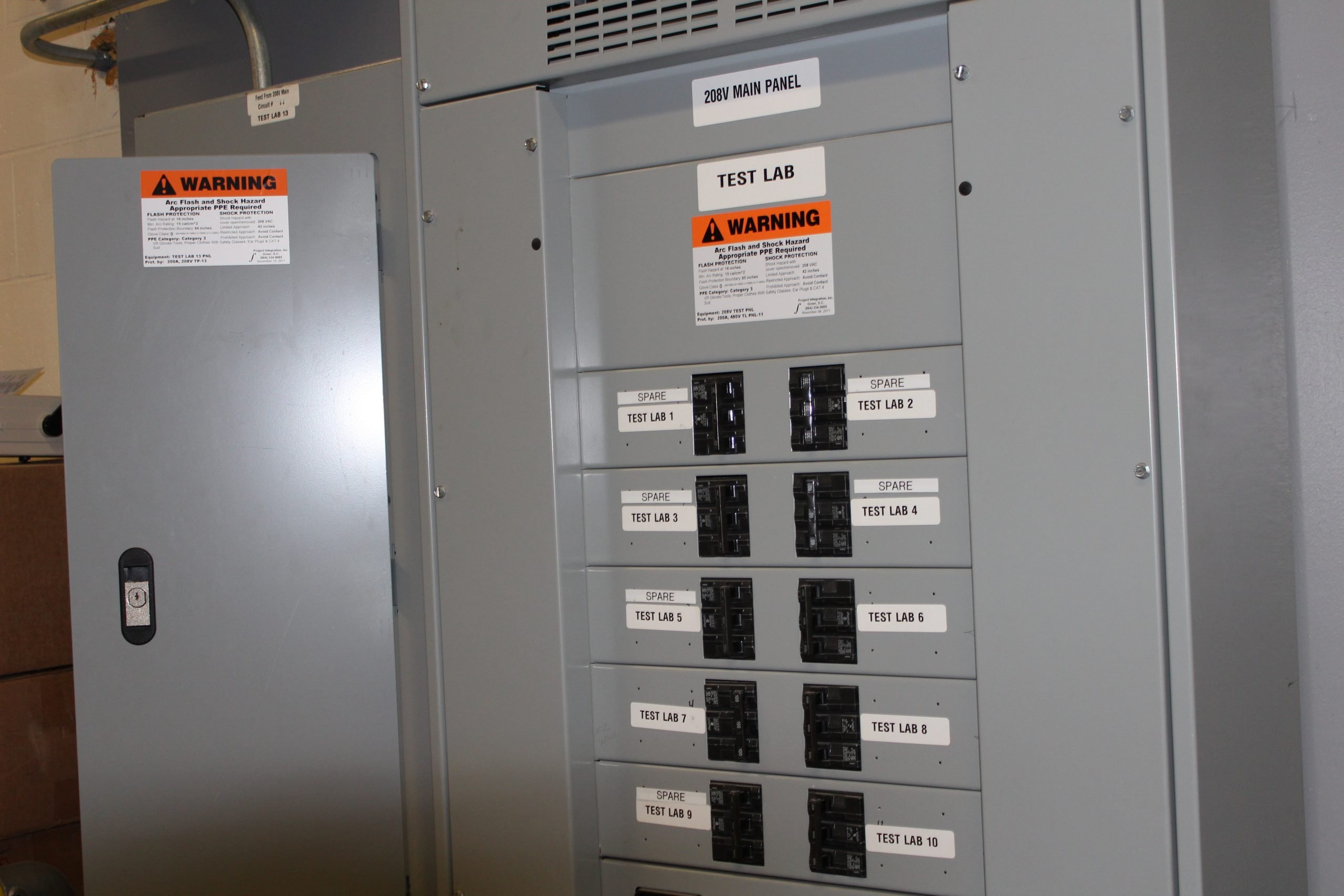

Just because Exception 2 provides conditions where detailed information may no longer be required on the label, the need for labels has not been eliminated. The NEC still has its requirements.
110.16, Arc Flash Hazard Warning: Electrical equipment, such as switchboards, switchgear, panelboards, industrial control panels, and motor control centers that is in other than dwelling units and is likely to require examination, adjustment, servicing or maintenance while energized, shall be field marked to warn qualified persons of potential electric arc flash hazards.
