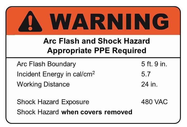

A common question that I receive during both my NFPA 70E and Arc Flash/IEEE 1584 classes:
Is the date required to be the arc flash (equipment) label?
Two standards can provide insight into the answer to this question: Â
-NFPA 70E Standard for Electrical Safety in the Workplace
-NFPA 70 National Electrical Code.
I added the word (equipment) to arc flash label above because although most refer to the term “arc flash” when discussing labels including the National Electrical Code 110.16, the term “Equipment Labeling” is used in NFPA 70E 130.5(H).
NFPA 70E 130.5(G) Incident Energy Analysis Method.
This section states:
“The incident energy analysis shall be updated when changes occur in the electrical distribution system that could affect the results of the analysis.”
This section also states:
“The incident energy analysis shall also be reviewed for accuracy at intervals not to exceed 5 years.”
This second line is generally interpreted as a need to review the study every 5 years and possibly revise it if necessary – including the labels. However, how do you know when the “5 Year Clock” begins?
A common response might be: “We start the clock based on the date of the study that is also listed on the label.”
However, did you know that NPFA 70E does not require a date on the label and the National Electrical Code only requires the date in specific instances? Let’s explore the details.
NFPA 70E 130.5(H) Equipment Labels
This section begins with what equipment requires a label.
Electrical equipment such as switchboards, panelboards, industrial control panels, meter socket enclosures, and motor control centers, that are in other than dwelling units, and that are likely to require examination, adjustment, servicing, or maintenance while energized, shall be marked with a label containing all of the following information:
1) Nominal system voltage
2) Arc Flash Boundary
3) At least one of the following:
Available incident energy and the corresponding working distance, or the arc flash PPE category in Table 130.7(C)(15)(a) or Table 130.7(C)(15)(b) for the equipment but not both. (I discuss the history of how “not both” was added to the 2009 edition during my NFPA 70E training class.)
Minimum arc rating of clothing
Site-specific level of PPE
In the above language, adding a date is not mentioned.
Requiring the date has come up during the NFPA 70E revision cycle and each time, including the date is left up to the owner or person performing the study.

In other than dwelling units, in addition to the requirements in 110.16(A), a permanent arc flash label shall be field or factory applied to service equipment and feeder supplied equipment rated 1000 amperes or more. The arc flash label shall be in accordance with applicable industry practice and include the date the label was applied.
Informational Note 2 of this section references NFPA 70E.
FINALLY! Including the date on the label is mentioned. But only for service equipment and feeder supplied equipment rated 1000 amperes or more. Â
Although NFPA 70E does not require a date on equipment labels and the NEC only requires a date on arc flash hazard warning labels for service equipment and feeder supplied equipment rated 1000 amperes or more, many people prefer to include a date as a way to keep track of the five year review requirement.
